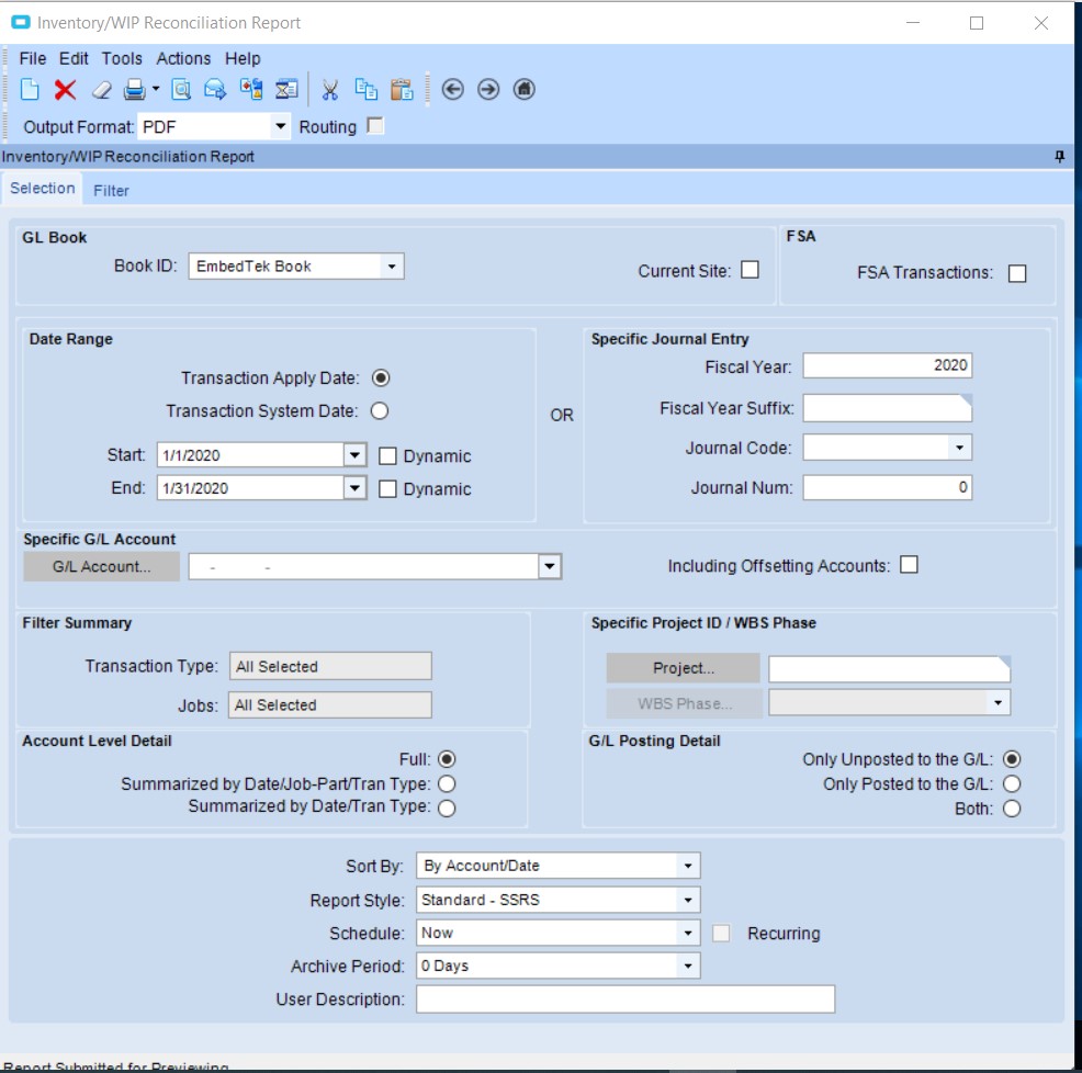

We are trying to run the inventory/wip reconciliation report

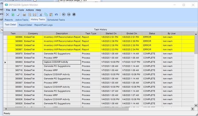

Getting the transaction date is in a close period.
I tried to change the dates to just today and still get the error message.

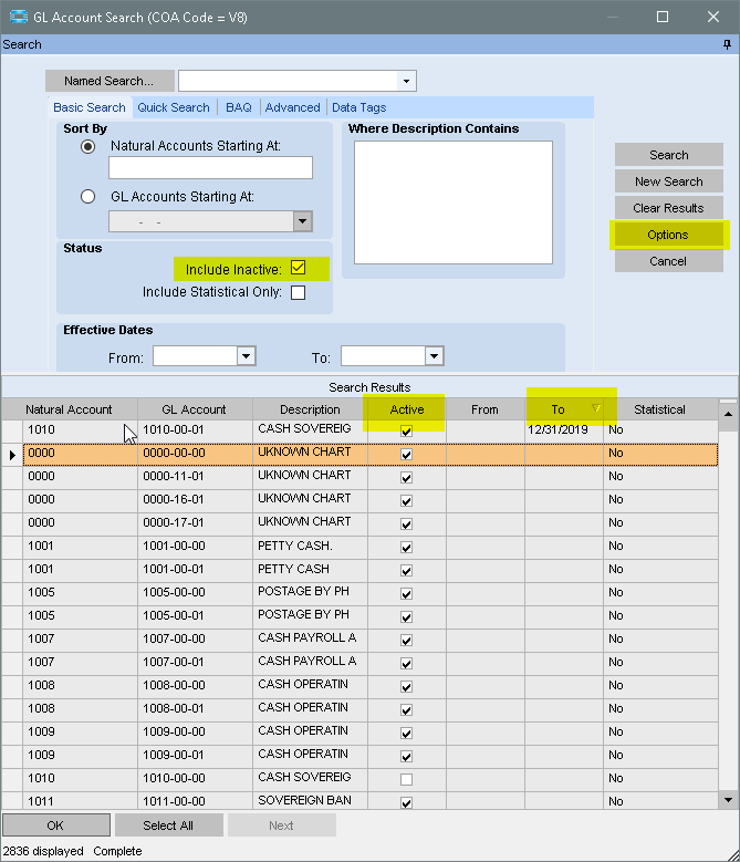

Any chance a GL Account has been disabled or had its end date set to 12/31/2019, and there is a transaction that would hit that account?
Try running the Capture COS/WIP process without posting. I bet you get the same error.
How would I find a disabled GL account or one that has an end date?
it looks like the Cos/wip process is working.
well as of this morning that is.
Use GL Account Maint, and when you search you can say to include Inactive GL accts.
I’d also use the options button and select Returna All rows
Then just click on the Active or To column header to sort, and scrol to the top or bottom, to see if any are inactive or have a to adte.
So if you set it to 1/1/2020 to 1/7/2020 it works?
If that is the case, I’d query the PartTran table for transactions that have a SysDate of 1/8/2020. See if any have a bad tran date (like like a fat-fingered year)

Aslo, have you tried running WIP Recon using the Transaction System Date from 1/8/20 to 1/8/20?
