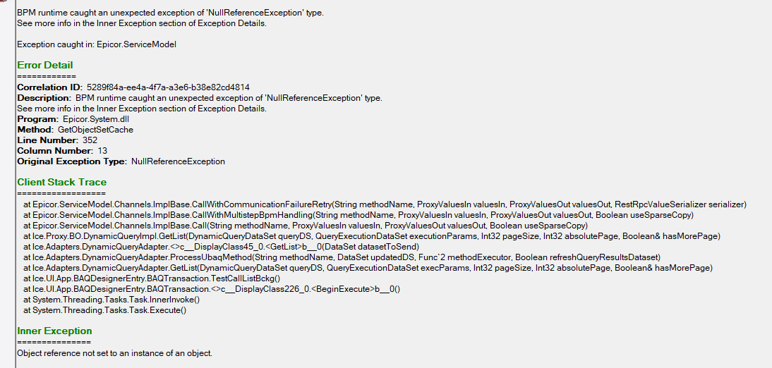

And here is the resulting error when running the check in method:
Any ideas on what the culprit could be?
Found the solution here:
Wild I have to call service renderer again just to check in.
