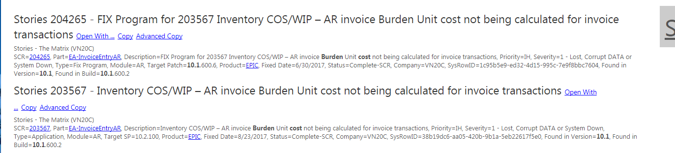

I came across your post here from close to a month ago due to similar error we are experiencing on 10.1.600.5. Did you get it fixed? I think that the SCR 204265 is supposed to help. Epicor is refusing to provide a one-off and telling us to upgrade yet again to 10.1.600.9. We’re trying to stabilize from this upgrade a month ago… they’re killing us

SCR 204265

We got a one off for 10.1.600.5 and sql fix for 203567. Tell support a one off has already been created for your version (CS0000585989 - 09-07 OOR 203567 IWR Report missing Invoice ).
We found that using this sql select statement (modified from Epicor’s update query) let us know records in error. If yours get pulled with this, then maybe this 203567 fix will help you too.
