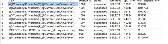

This is the first time I encountered the App server out of memory, the query became suspended on the SQL server so SQL server didn’t run out of memory but the App server had the IIS process that consumed all the memory. Is there a way to prevent the App server from consuming all the memory?

I check on our SQL server, I had a lot of suspended query. I suspect it was the user pressing refresh multiple times and caused this to happen.
In the mean time, I have limited the amount of data being returned to 1 year. I will go and do some testing on the test server to let you know how long it takes for that particular query to finish.
