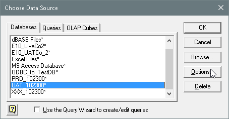

  3. Choose the ODBC connection. (look in one of the existing Excel Files that has the connection that works, to see which one to use

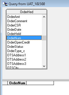

  4. Add the tables you need. (Start with just one. You can add more later)
  5. Double click or Drag the columns you want to the grid area

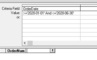

  6. Add any criteria to limit the results (you may have to click the Show Criteria button)

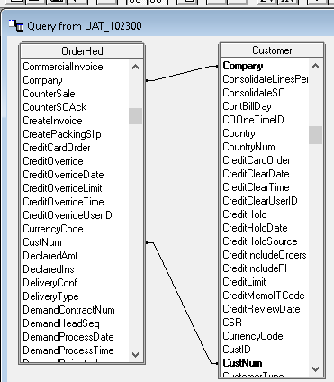

  7. Use the Add Tables toolbar icon to add other tables
  8. Connect the tables to indicate how records are joined.
