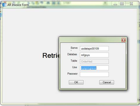

Anything wrong with doing this? I ask because occasionally a user will go to print invoices and be presented with a dialog box that looks like it is looking for login info for the ODBC connection.
Entering the correct password doesn’t resolve the issue. And when this happens, there are some error log entries about too many connections.

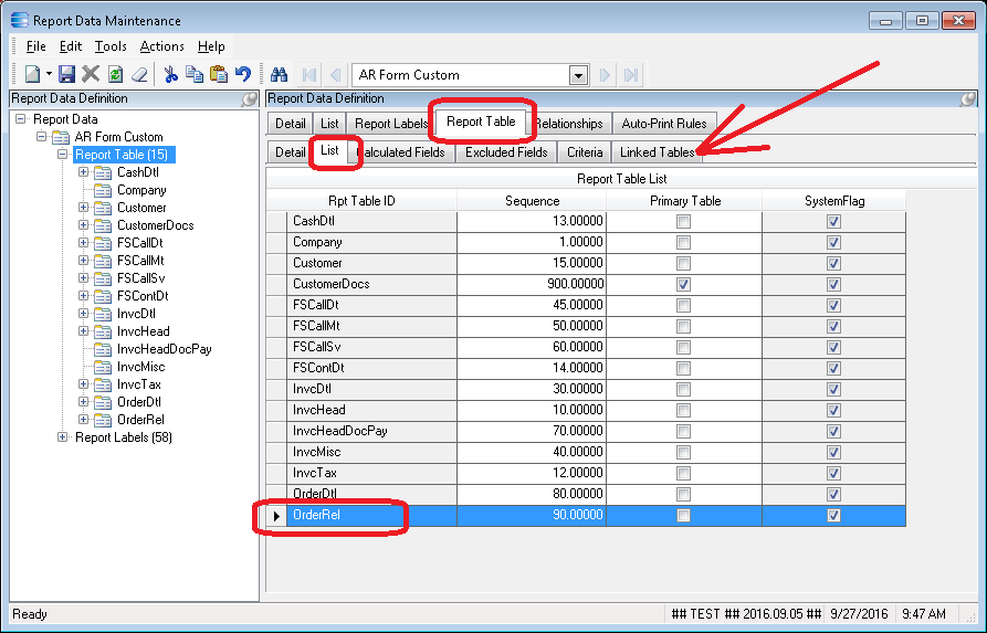

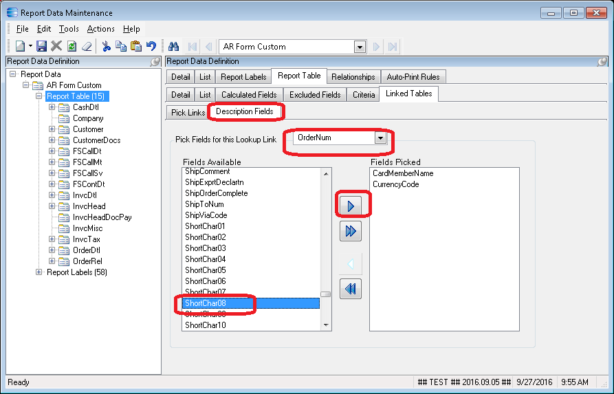

Open your ARForm RDD. Go to the Report Table tab, List tab and click on the OrderRel table highlighted below. Then, click on the Linked Tables tab.

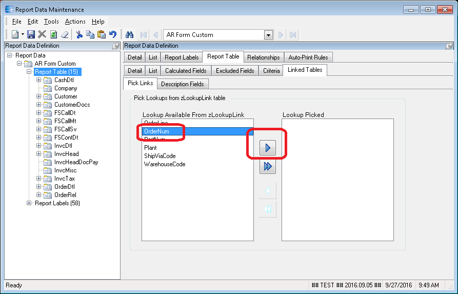

In Linked Tables, in the left column “Lookup Available” choose “OrderNum” which is a bad way to say you are selecting the OrderHed table. Once it is in the right column, “Lookup Picked” press SAVE. You must press SAVE. (bug). Then…
Flip to the Description Fields tab, ensure “OrderNum” is selected in the drop down and then scroll down and select your ShortChar08 field and move it over. Save. Run your ARForm again. Take that XML sample and pull it into Crystal and you will see your OrderNum.ShortChar08 under the “OrderRel” dataset/table in Crystal.

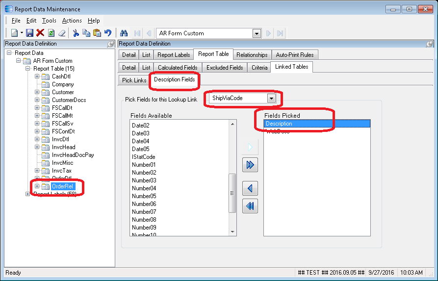

For your ShipVia.Description, you can still get to it from a Linked Table from OrderRel just like above. “ShipViaCode” is the “table” you want and you can then pull in your ShipVia.Description field like shown below.
Doing it this way keeps everything contained in one XML file for your Crystal ARForm and circumvents your need for a subreport and ODBC connectivity.

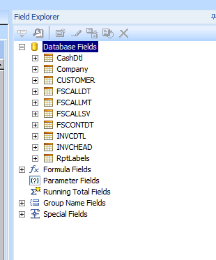

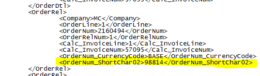

Did everything you said, but when I load the new XML file I don’t see the OrderDtl or OrderRel tables in CR’s field explorer.
I know I did the RDD update properly, as the new data is in the XML File (snippet below)
Hmmm … cant past a snippet of XML code… I’ll try a screen shot
Is the OrderRel data stored in one of the other “tables” listed?
Calvin

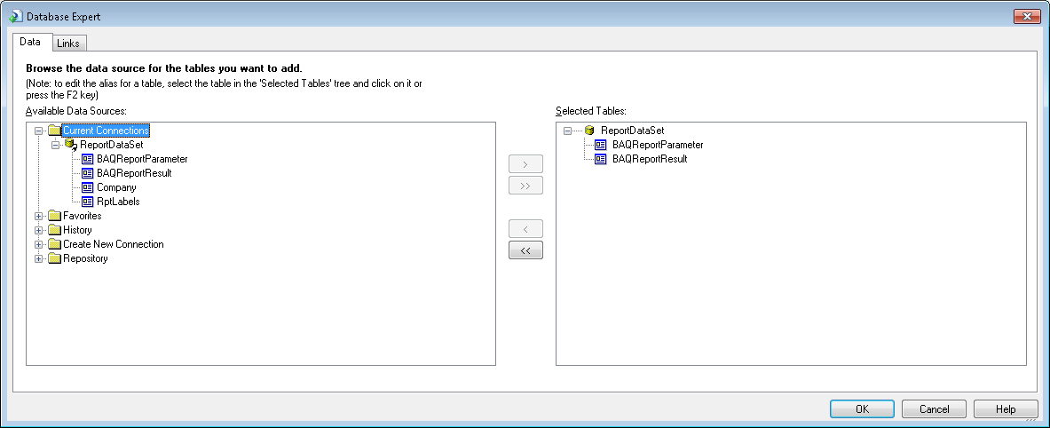

Strange, OrderRel is not an active table? OK, in Crystal, preview the data (F5)/open the XML sample. Once it’s open, in Crystal, on the menu, go to Database and then choose Database Expert. On the left side under Current connections if you see the OrderRel table, add it. It may/should ask you to link the new table with a relationship, go ahead and do so… OrderRel should join fine with InvcDtl already in your dataset above. Once you get it added in Crystal, your fields will be under the OrderRel table prefixed with “OrderNum_”.
To see the new fields in Crystal Reports, you need to create an XML by running the report. Check to see if the new fields are in the XML. Then in Crystal, set the database location to the XML. The fields should then be available automatically but you may have to refresh the database.

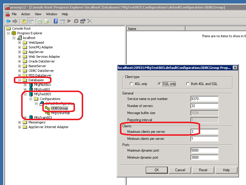

It’s been a while, but because this is ODBC related, you may want to try this first in PET:
Look below; navigate to your live DB (mine is TEST) and drill down to ODBCGroup and right click on it, Properties and modify my circled value to something higher. Restart your appservers and db to apply.
I’ll try adjusting the Clients per server number in the ODBCGroup first. And see how that goes before messing with the .pf file.
