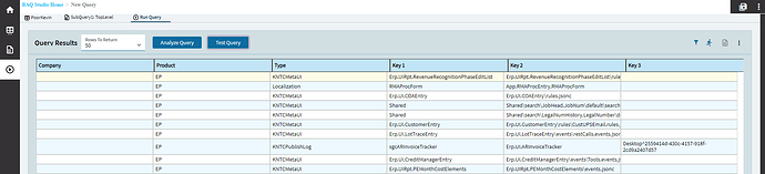

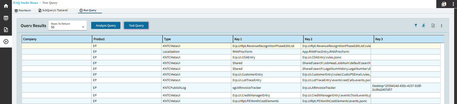

Error: “Restricted tables access: Reference to restricted table XXXDef detected”
(when a reaction emoji just isn’t enough)
I’m hoping there is a bug, or an oversight.
Found references to this when debugging:
