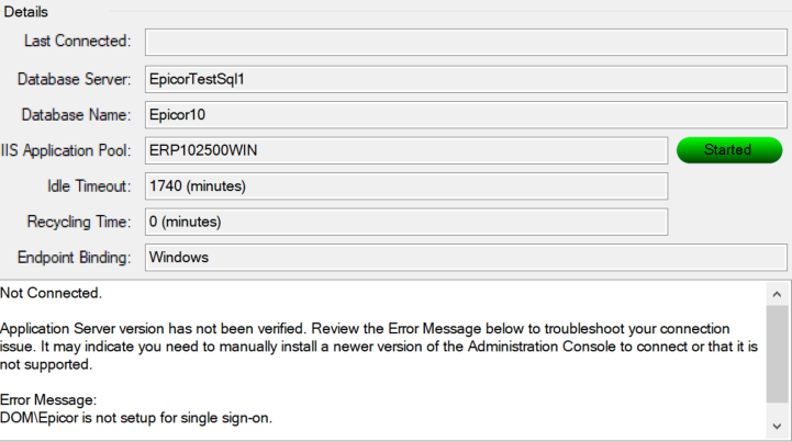

I’m testing adding Windows authentication to our Demo 10.2.500 server. I’ve added a new application server that points to the same database but I cannot connect to the application server. I get the error that the user is not setup for SSO.
But in the User Account:
What might I be missing?

Yes. I am logged in as that very user while running the Admin Console as well.
When you configured the App server binding did it test successfully? Might be helpful to see that config too. I have a .500 environment I could compare to

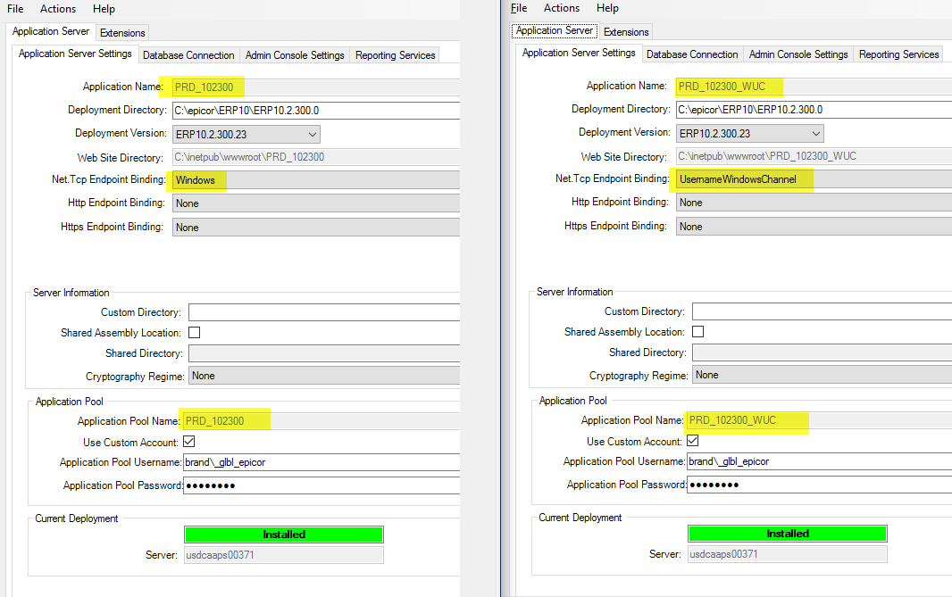

We use Windows binding on our primary App (PRD_102300). And I added another App(PRD_102300_WUC) to use Windows User Channel (actually called “Username Windows Channel” in EAC), and everything works fine.
Here’s the first Sheet settings for each
The second sheets (Database Connection) are identical
The 3rd sheet (Admin Console) has a significant Diffs. User Win Channel requires an Epicor user and password to be specified (one that is a Sec Manager, I’d guess)

  • None of our E10 user accounts have “SSO Required” enabled.
  • Make sure the “Domain” and “Domain User ID” are set for the account that you specify in the Admin Console settings sheet
  • Launch EAC using the account specified in the EAC Admin Console Settings.
    (edit: Or at least as a domain user whose E10 user is a Sec Manager)
Boom. I’m in.
Soooooo, when you’re testing with the Education database, be sure to point your appserver to that database and not your upgraded database. :man_facepalming:
