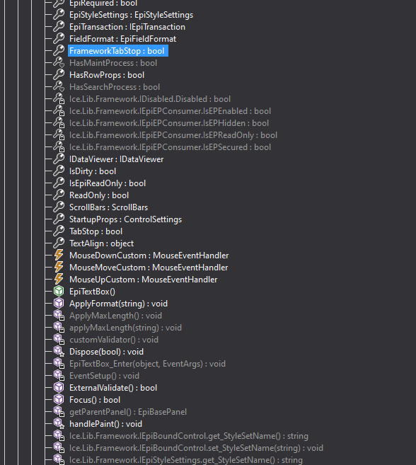

klincecum:
EpiTextBox
Stabbing in the dark, but have you tried MouseUpCustom?
