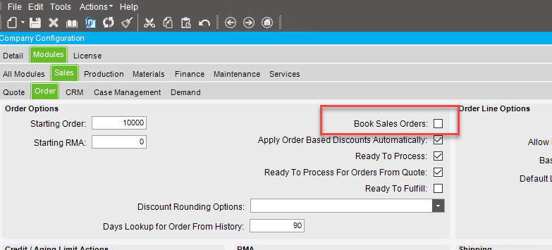

I think you can get what you want from the BookRel table. The close short will show as a Void
Nice! I forgot about that.
BookDtl table.
If you don’t use the Book tables could you use the Changed By \ Changed Date fields?
Either option would need to be enabled.
Book Orders needs to be turned on in company config.
Changelog needs to be enabled via Data Directive and the correct fields selected.

And the Bookxxx tables are not updated until you click on Ready to Process.

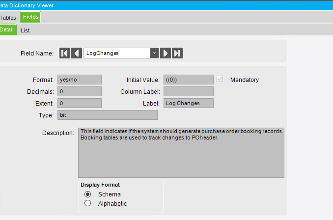

Talking about booked orders. I note that there is a field on POheader.Logchanges.
The data dictionary goes to state:
“This field indicates if the system should generate purchase order booking records. Booking tables are used to track changes to POheader.”

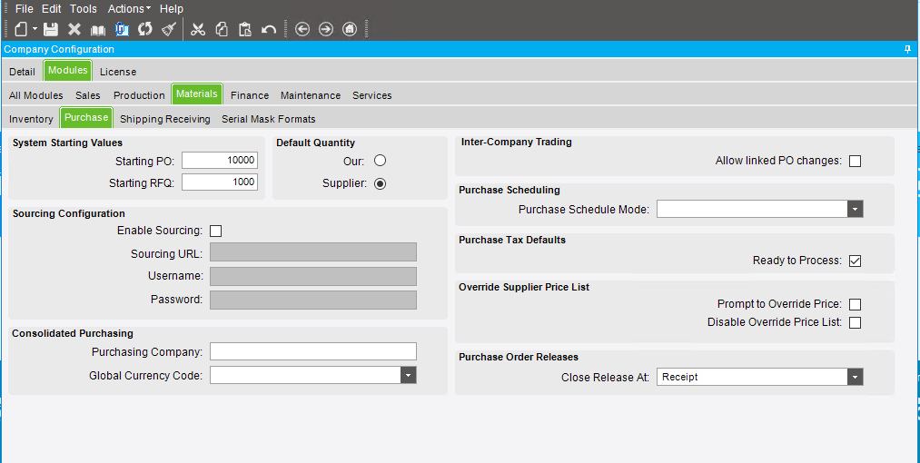

Is this functionality that is yet to work or am I missing the point of this field? I don’t see a field related to this in company configuration that is similar to the Book SalesOrder checkbox on the Sales tab, not even sure if it is meant to me the same.
Thoughts?
It seems like you’re probably right. Like they either intended to set it up the same way, but didn’t follow through? Or it was set up that way in the past but was abandoned (perhaps once they made Change Logs a thing)?
Good question.
I thought change logs existed forever… Pretty sure they were in 9…I could be just hallucinating…
