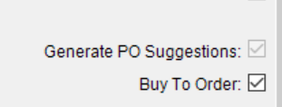

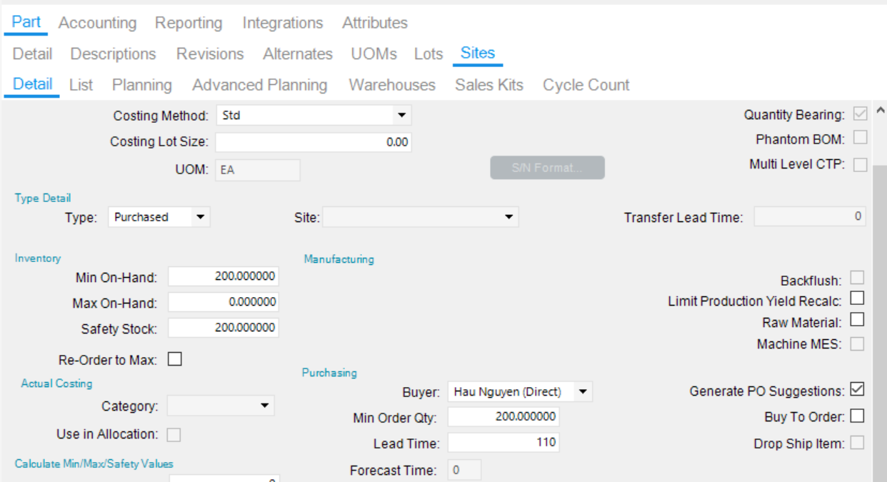

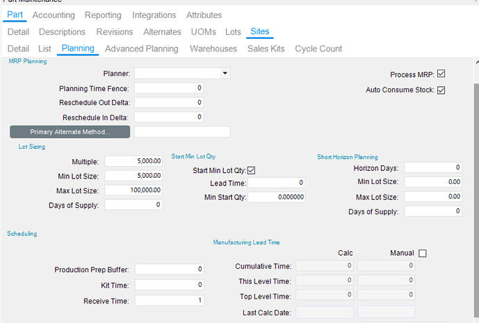

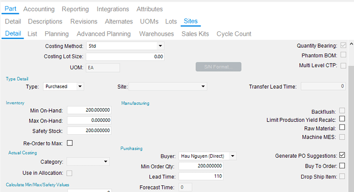

I set up fields as pictures:
  • Manufacturing Part:
  • Purchasing part:
    I have a SO for the manufacturing part.
    After running MRP process for manufacturing part, I don’t understand why PO suggestion didn’t suggest for material part (purchased part).
    Which fields I should add or remove? Any suggestion? What should I do?
I highly appreciate for your support.

I am a bit confused and I am no MRP expert either. But your Purchased part does not have the BTO flag checked. I would have thought that for PO suggestions to be made the On hand qty-demand would have to be less than the (in your case) the min On-Hand/Safety stock.

In your pictures - not seeing all the key fields.

Your manufactured part is set as Buy to Order.
If it is - then it would drive a PO suggestion for the mfg part.
Setup parts as follows
Manufactured Part
  • Site settings
    • Non-Stock = True (drives make to order)
    • Buy to Order = False (if you want to make the part)
    • Qty Bearing = True
    • Process MRP = True
  • Revision Setting
    • Approved Revision
    • Purchase part on the BOM
Purchased part
  • Site settings
    • Qty Bearing=True
