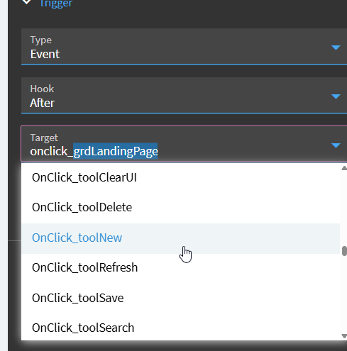

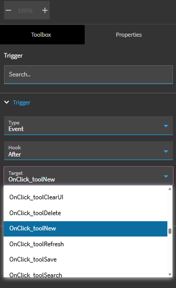

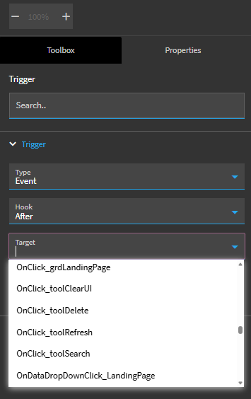

As the title suggests, I cannot use the onClick_toolNew as a target for my trigger in an event, as I cannot see it within my custom layer.
I can see the event fires in DevTools.
While I’m at it, i cant see the onClick_toolSave event either.
They’re both there in the base layer.

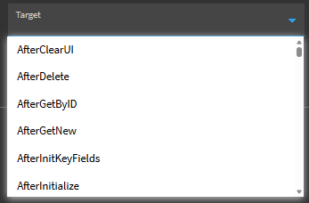

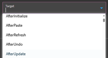

You must have already added an after event because this shows up in UD05 when starting fresh. Go in your actual list of events and do a search for custom events. If it still doesn’t show up, close everything and log back in again.

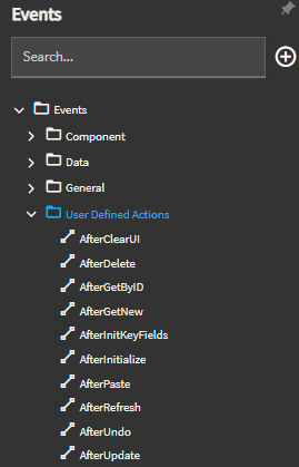

Only got these in User Defined events for “After”
Use the application shell filters to see all your user defined events like in my screenshot.
