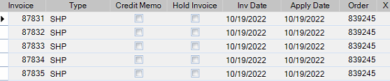

@Ernie I think this is no checkboxes and the default behavior. I just did 5 pack outs for the same customer and same sales order and got 5 invoices.
Yes… but in this instance there are multiple sales orders on a single pack slip. Pack Slip 1 has 2 separate sales orders, and Pack Slip 2 has 2 more separate sales orders. With any combination of checkboxes (or no checkboxes) selected, I get either 4 invoices (one per sales order) or 1 invoice (with everything combined). The goal is to get 2 invoices (one per pack slip).
