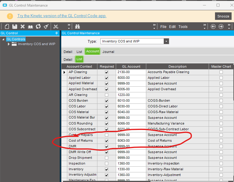

Review Journal most likely a missing GL account tied to something is the most common cause of one-sided journal items.
We had this happen once. It was due to a GL not being set up for the Cost of Returns. Check that maybe?
Thanks guys, will pass this on to the finance team and see what they say.
If this is the case, how do we fix current stuck Journal ?
It was several years ago but if I remember correctly the Finance team was able to do a Journal Entry into that account after it was created. I don’t think we were able to back out the original RMA receipt that caused the issue.
Remove from review journal and fix the errant items missing GL code then just reprocess.
