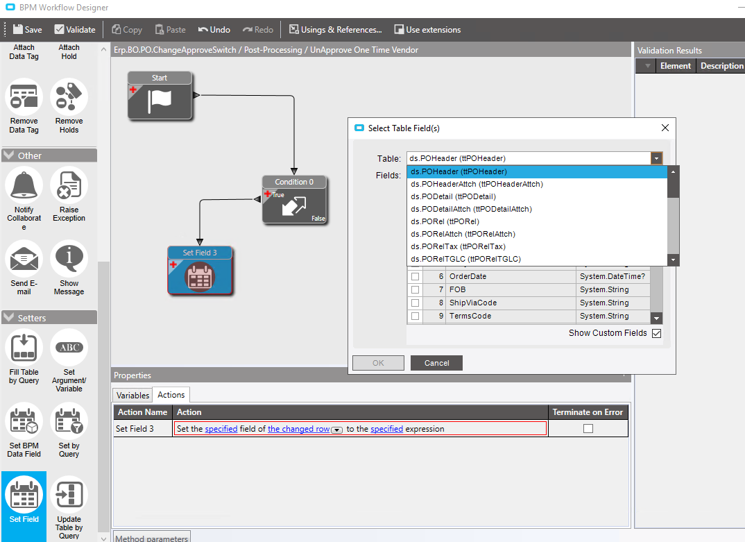

It seems like user wanted to track their one-time-supplier as well, so creating a general supplier ID isn’t suitable for them (if my understanding is correct).
I’m exploring a method to add a UD checkbox in vendor table to flag one-time supplier.
After that, I will build a BPM to set vendor.approved = false if the UD checkbox = true.
However, I can’t seem to be able to set field for vendor table in PO business Object as the vendor table isn’t listed.
I’m wondering if there are other method to perform the update?
