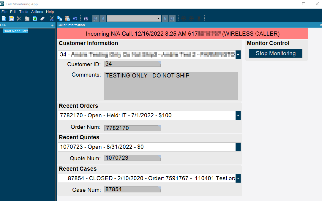

Sure - Our company (before my time here) created a call monitor app that interfaces with our Mitel system, and brings up the customer information… It’s been in use for ages, and still works fine in Kinetic2022.2. There are some threads about this from the old yahoo group archives that could get you thinking in the right direction.
