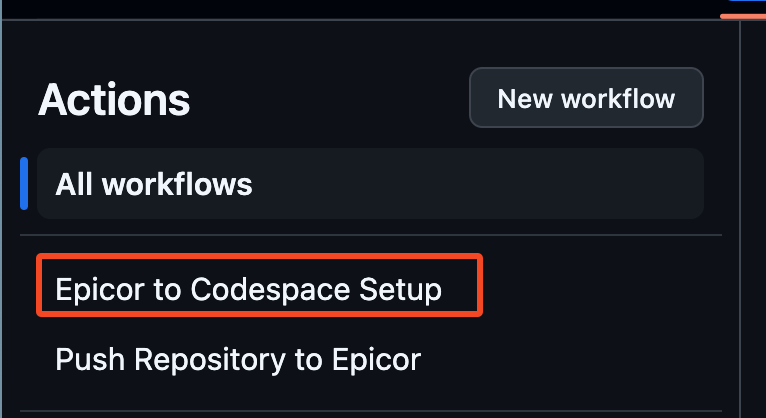

After following the README and setting things up, you can navigate to your repo and do the following:

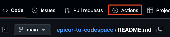

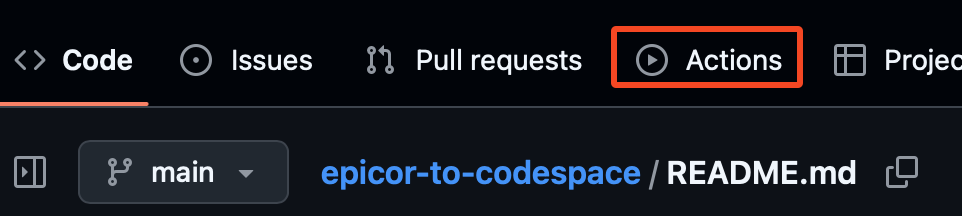

Go to the actions tab
Select the Epicor to Codespace Setup workflow on the left

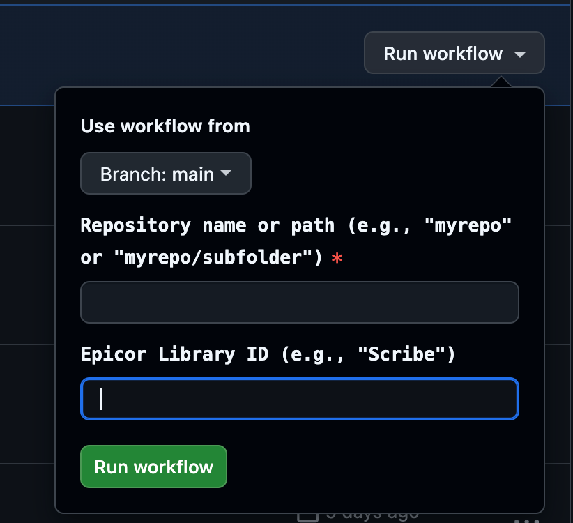

Click on the run workflow dropdown and put in your target repo (to clone the function library to and setup the codespace in) and click “Run Workflow”

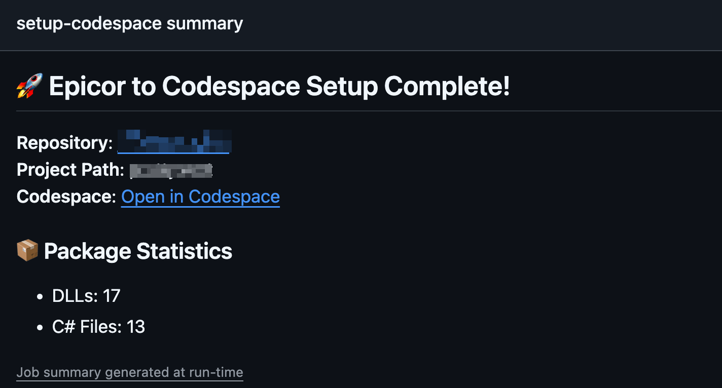

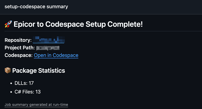

The workflow will run (will take a couple minutes to spin up the container) and when it is finished you will see a url returned for the repo and the codespace:

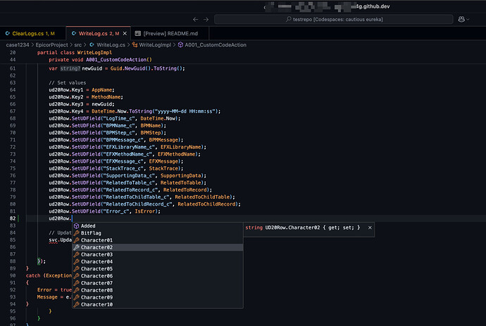

When you open the codespace it will finish setting up the c# extensions and then you should have full intellisense as you would expect:
