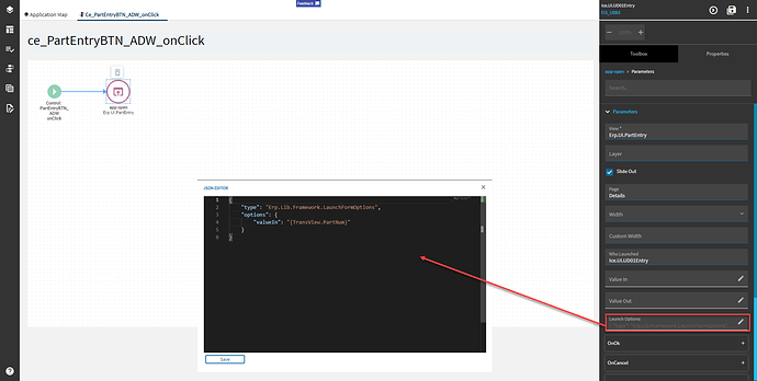

App-Open is the correct widget.

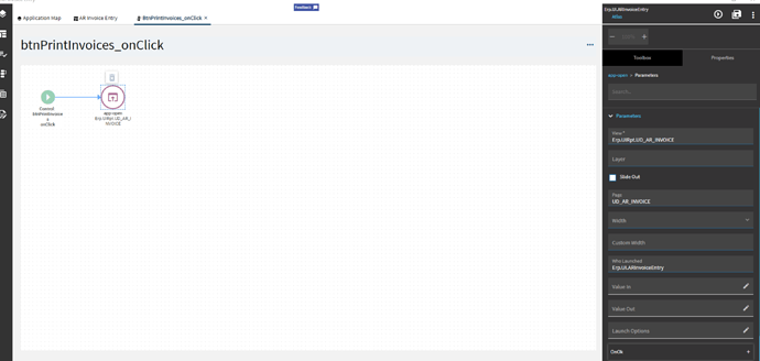

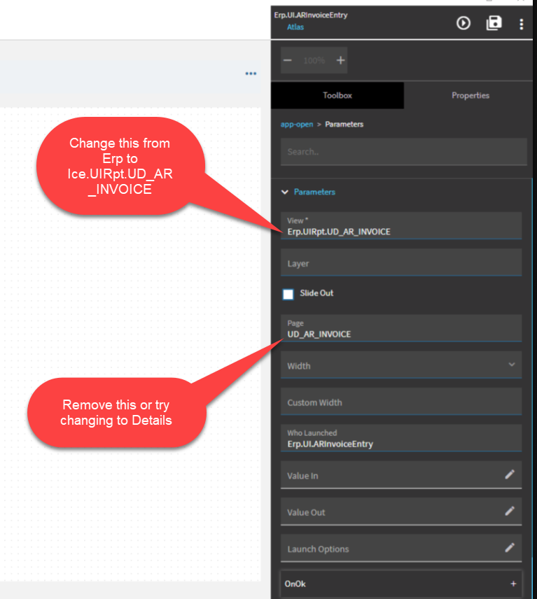

Here’s a screen cap of the parameters it’s looking for.
*If you uncheck “Slide Out”, it will open in a new tab instead of the slide out panel.
Just as a note–you don’t need to use TransView for your LFO binding. That just happened to be what I bound my test TextBox to.

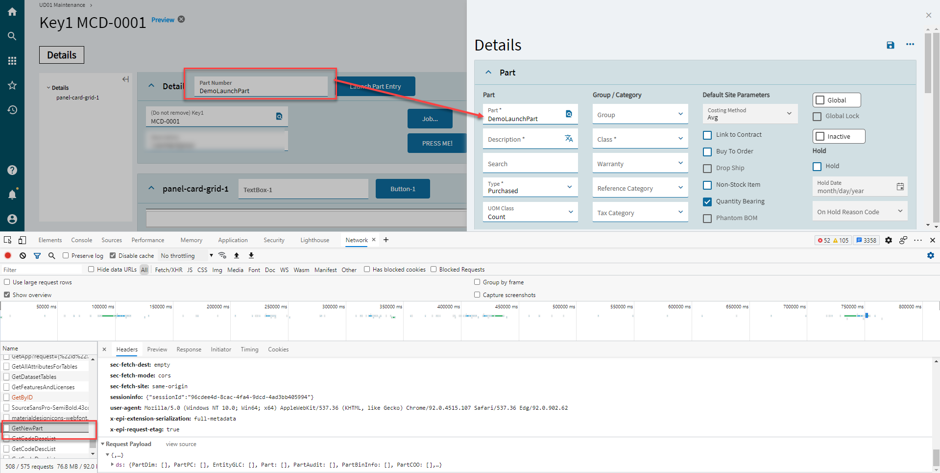

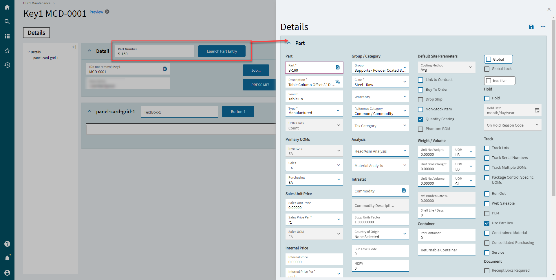

Something kind of cool (not sure if the old did this), but it automatically called GetNewPart if it couldn’t find an existing part.

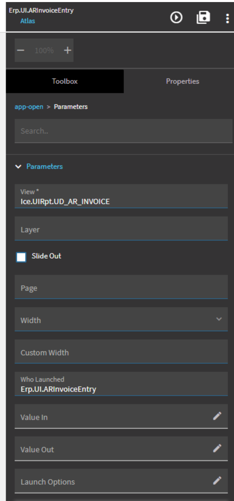

I was able to use your example to open some standard apps, but unfortunately when I tried to use it to open an app we created for a BAQ report (Ice.UIRpt.UD_AR_INVOICE), it gave me the below error. Have you run into it before?
“The assembly ‘C:\ProgramData\Epicor\centralusdtapp02.epicorsaas.com-443\4.1.100.0\19707\shared\CustomDLLs\Ice.UIRpt.UD_AR_INVOICE.dll’ could not be found.”

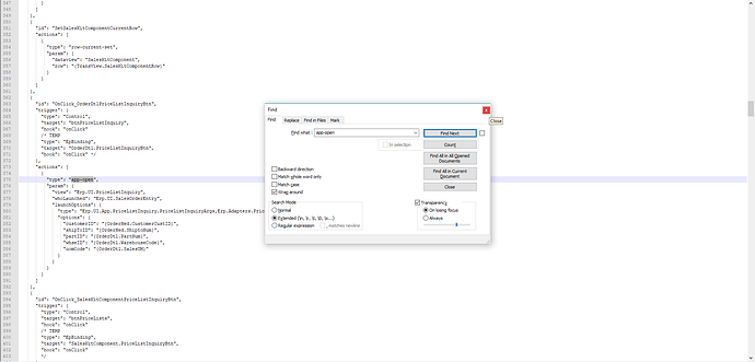

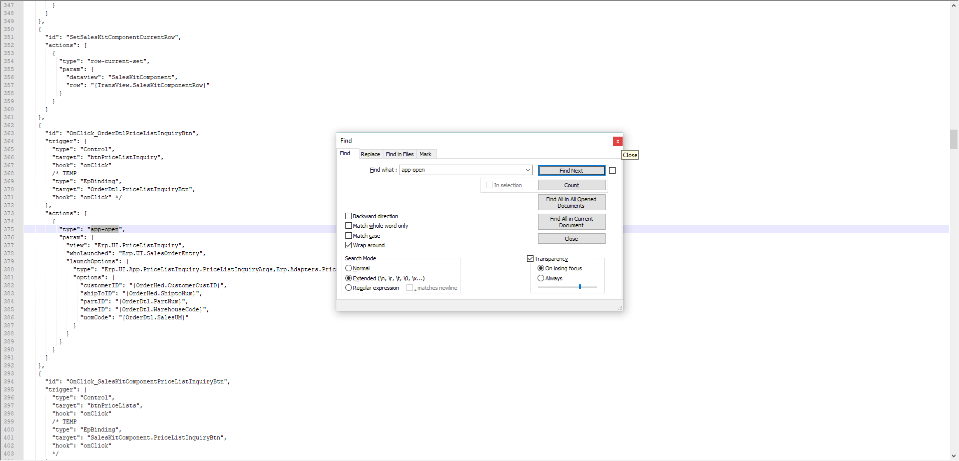

Little bit of both. I used Epicor as an example. Inside of the MetaUI folder, they have all of the JSON for the stuff they already converted to Kinetic. I opened up the SalesOrderEntry one and looked in the events folder. I opened up the JSON called OpenView.events.jsonc because it sounded like it could contain the info I wanted. Then I searched for “app-open” and played with the params based on what they set.

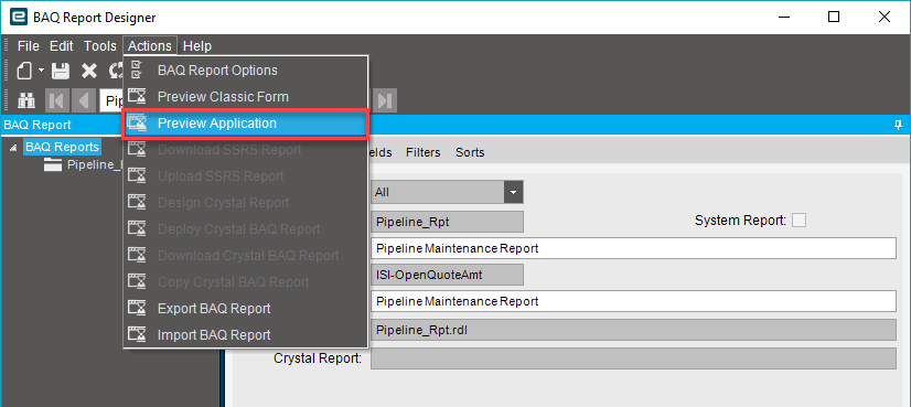

Are you able to preview the report okay through the smart client?

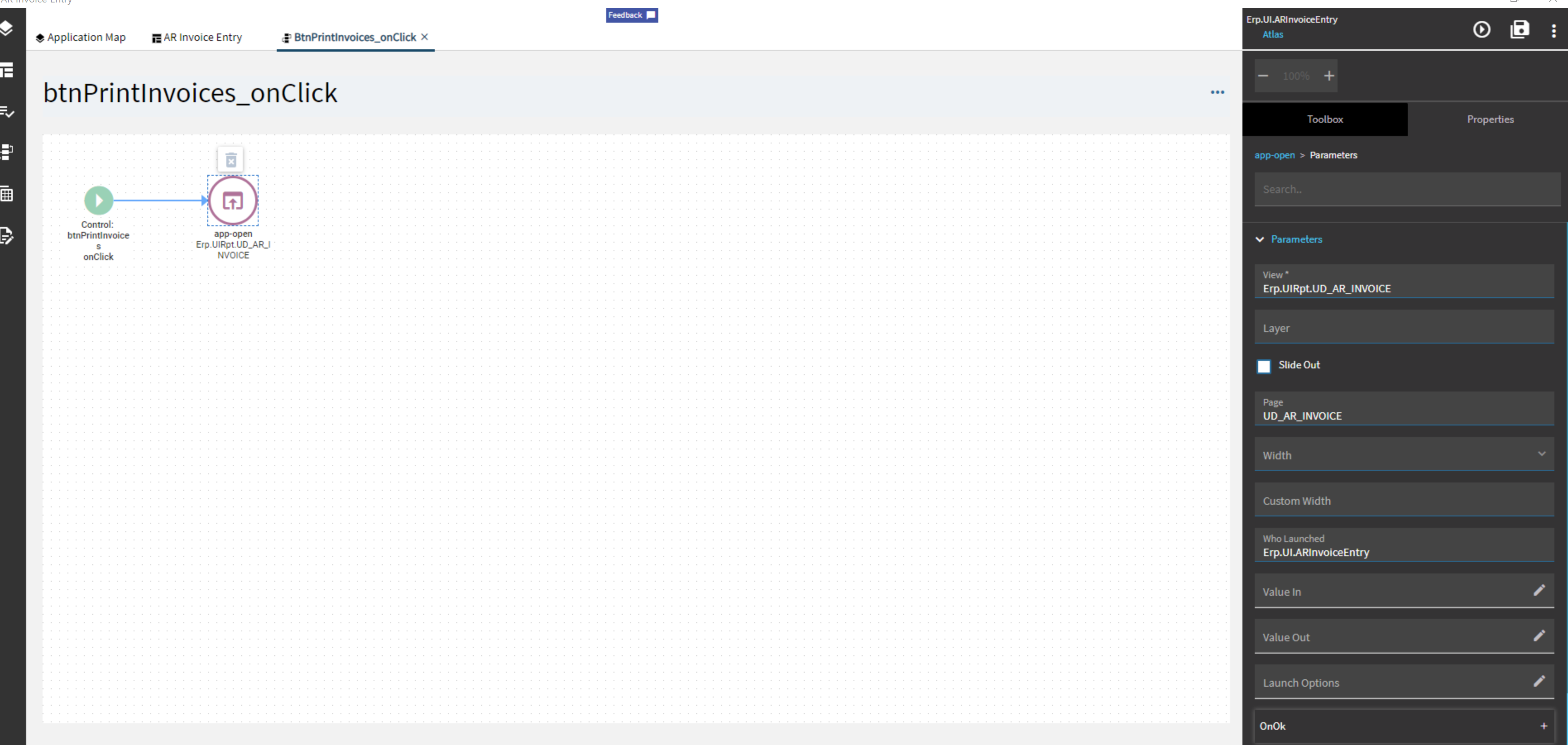

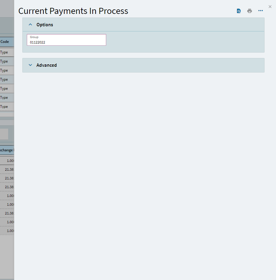

For the error, below is the screenshot for how I configured the on click event. I didn’t even try the lfo yet, I was just trying to see if I could just open the form. I’m able to preview the BAQ report app in Kinetic just fine, it just won’t open it from the button click. If I leave the “Slide Out” flag checked, then nothing happens when I click the button. If I uncheck the flag, then I get the error when I click it.
I think I’ll create a support ticket for my error message since the button works fine if I try to open a standard Kinetic app.

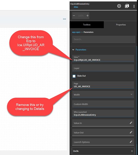

Try these changes:

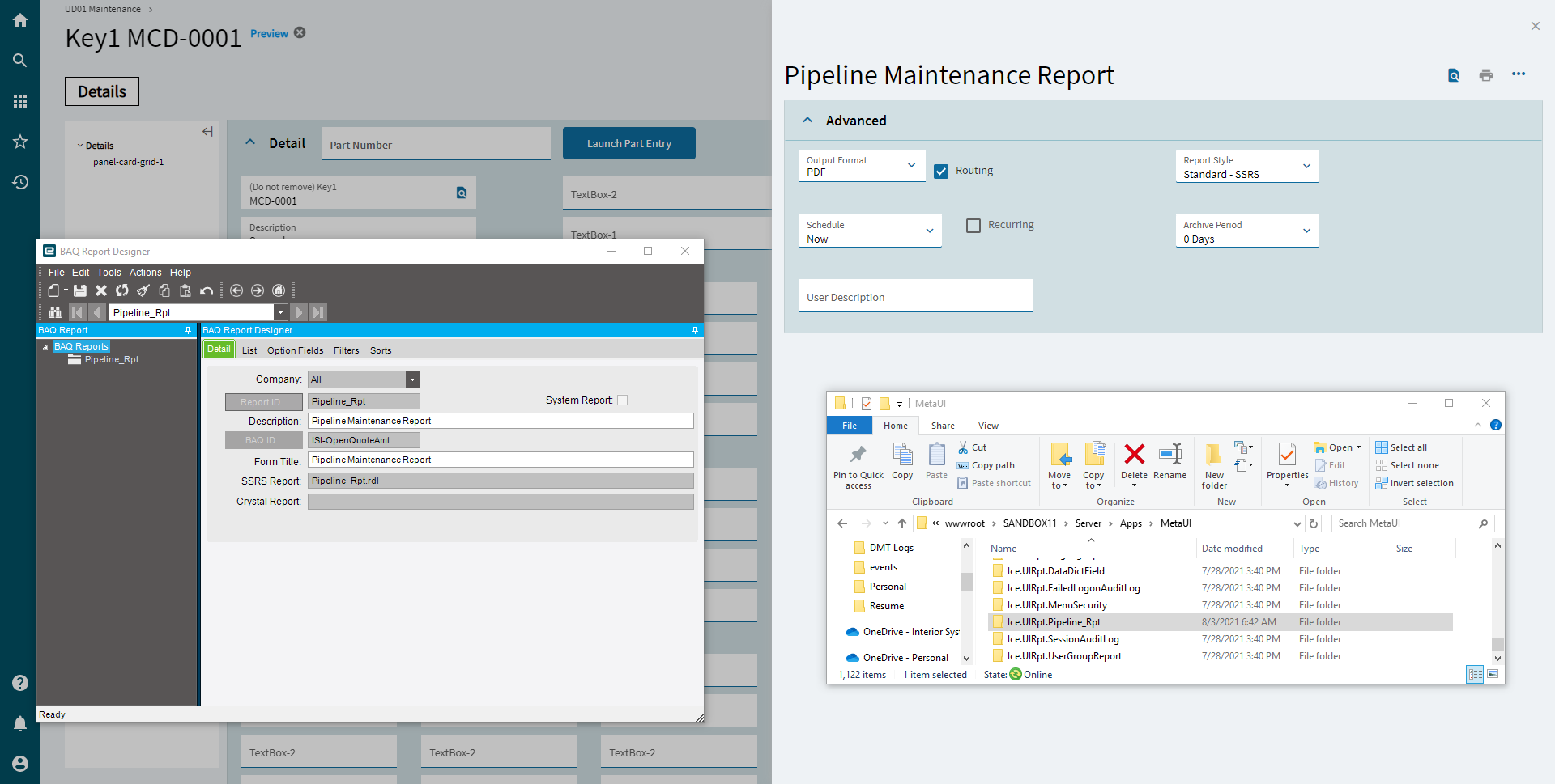

Ohh yes, I forgot. I tried a few ways and that screenshot was only my last attempt. I tried it with “Ice.UIRpt.UD_AR_INVOICE” yesterday. I also tried it with no “Page” and "Details.
Here is what my original setup was.
This message is tickling at the back of my head. What’s odd to me is it’s trying to locate something client side, but the stuff we wire up in App Studio lives server side…

This is the closest I got which happened prior to me previewing the report in Kinetic which is what generated the MetaUI files on the server.

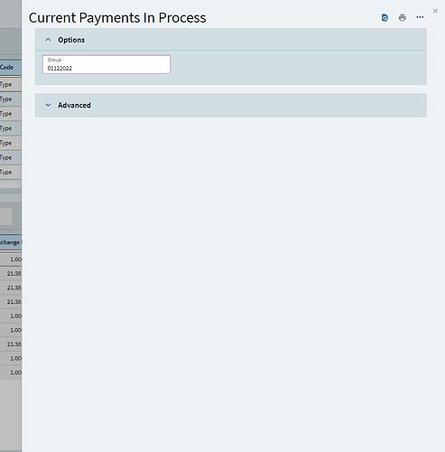

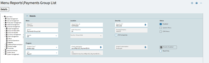

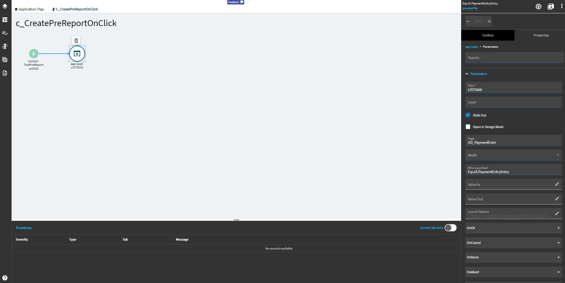

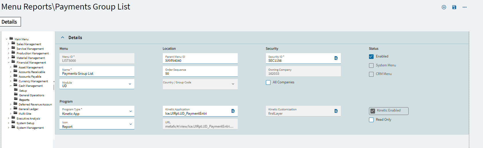

I finally figured it out:
  1. You need to publish your app and add it to the menu using the menu maintence.
  2. Instead of using Ice.UIRpt.**** as field you need to use the Menu ID generated in the previous step. (LIST5000 in my case). It will look something like this.
Hope it helps!

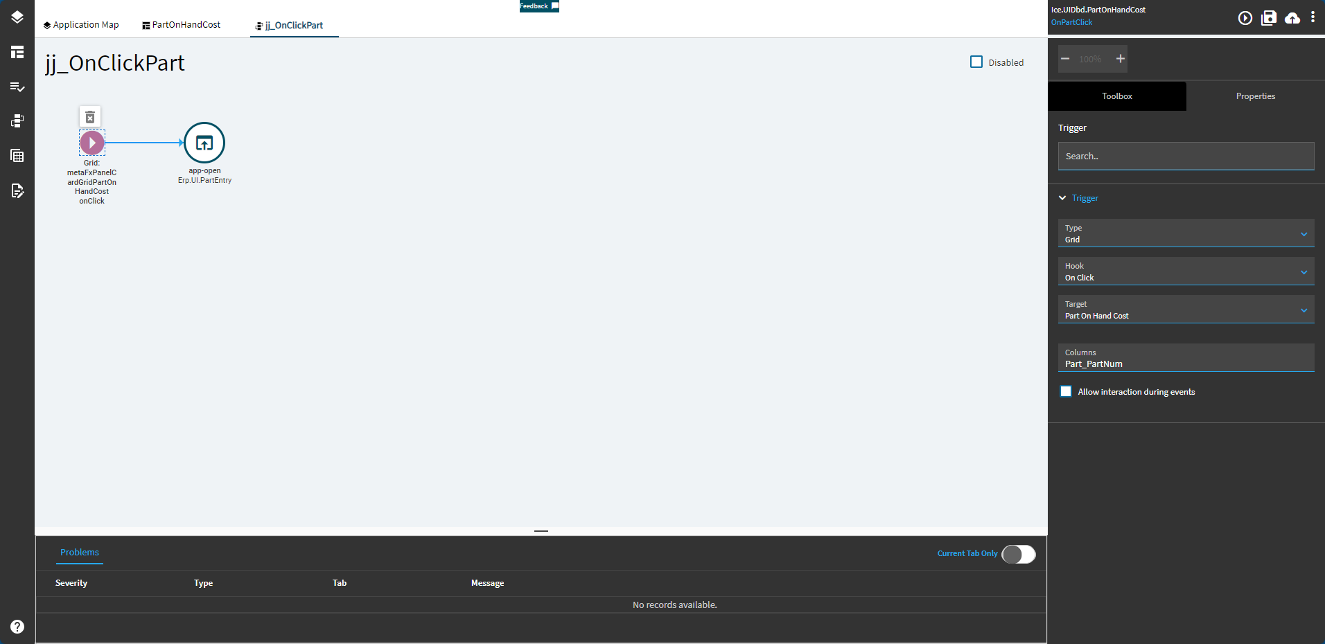

Hi Hanna, I tried this with a Dashboard grid on click but it doesn’t seem to work. Is there a diferent way for using the PartNum column with IsLink?
IsLink makes it clickable, but then you will need to create the event using Grid.onClick as a trigger.

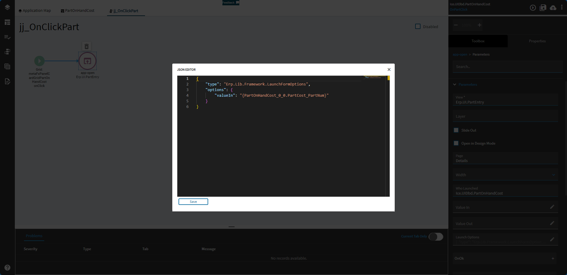

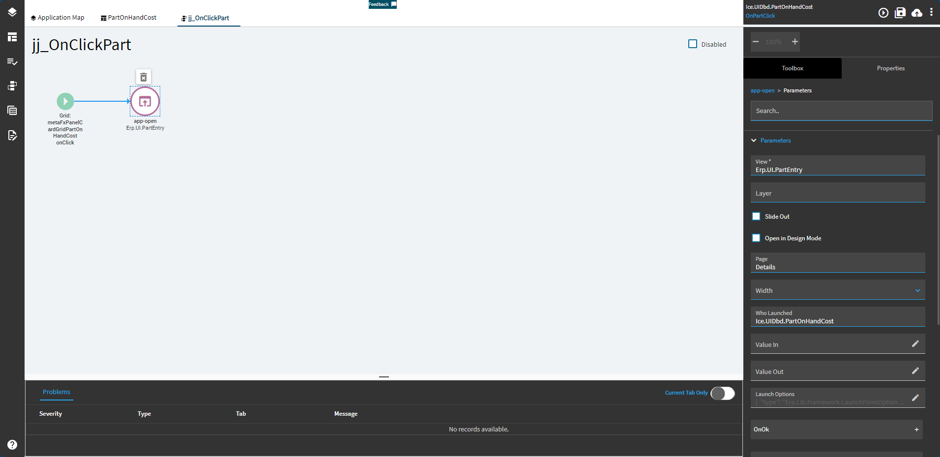

Here’s what I have so far but still no open on clicky
Your view needs to be the Menu ID (JM20033 or whatever it is), not the form (Erp.UI.PartEntry).
