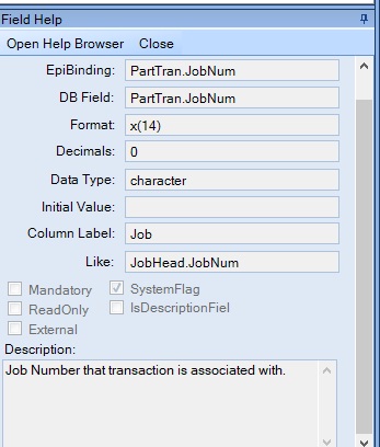

I opened up the Issue Material screen and went to field help and found the box I am wanting to populate the field is parttran.jobnum
I then went to customization mode and opened up Object explorer and changed the code to

I still think you’re barking up the wrong tree. I dont think that you are looking for the PartTran edv.
Use Help -> Field Help then click into the textbox where you enter the job. The epiBinding property should tell you both the edv and fieldname you are looking for.
Okay will look there. I just tried to open and got a “Exception has been thrown by the target of an invocation” error.
Here is pic of what field explorer says
pic
Also here are the Dataviews on the Issue Material screen
pic1

Well played with this code some more and remarked out the last line to see which one was causing it to bomb and found this line is the problem child.
edv.dataView[edv.Row]["JobNum"] = RcptToInvForm.LaunchFormOptions.ContextValue.ToString();
I’d venture to say that row is -1 which means there isnt one. You have to create a new transaction first.
