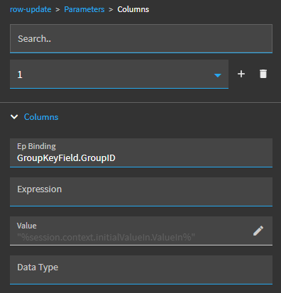

Create a new event (name it whatever you want):
Trigger: Event > After > SysAfterInitialize
row-update: GroupKeyField.GroupID
Value: "%session.context.initialValueIn.ValueIn%"
Save and Publish the Layer.

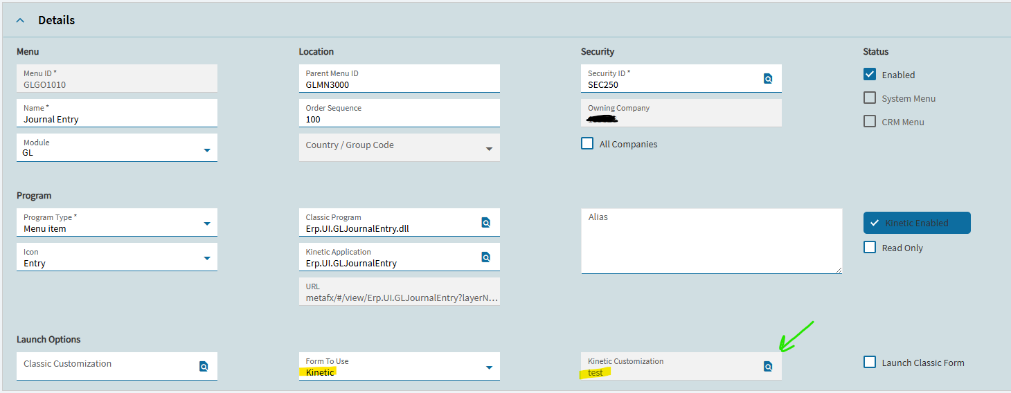

If you don’t already have a custom MENU for Journal Entry, you’ll need to do that as well.
Find Journal Entry in Menu Maintenance, copy to current company (from action/overflow menu). Set it to open in Kinetic. Add you custom layer that you just created.
Save the new menu.
Your NEW Journal Entry menu, which now has your NEW custom layer applied, will now fire your NEW event… which will update the GroupKeyField.GroupID value that is being passed by the Context Menu.

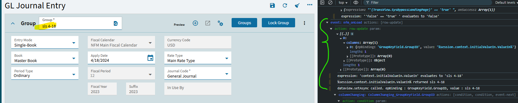

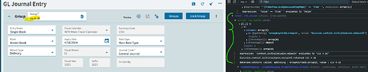

Results:
Right-click on a GroupID… Choosing GL Journal Entry (from my added context menu as it did not exist out of the box)
I can watch my event fire and load the “ValueIn”
