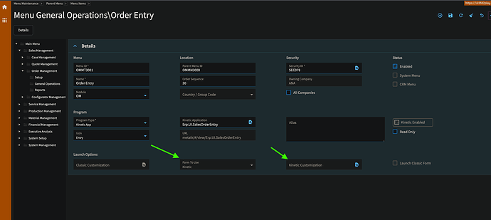

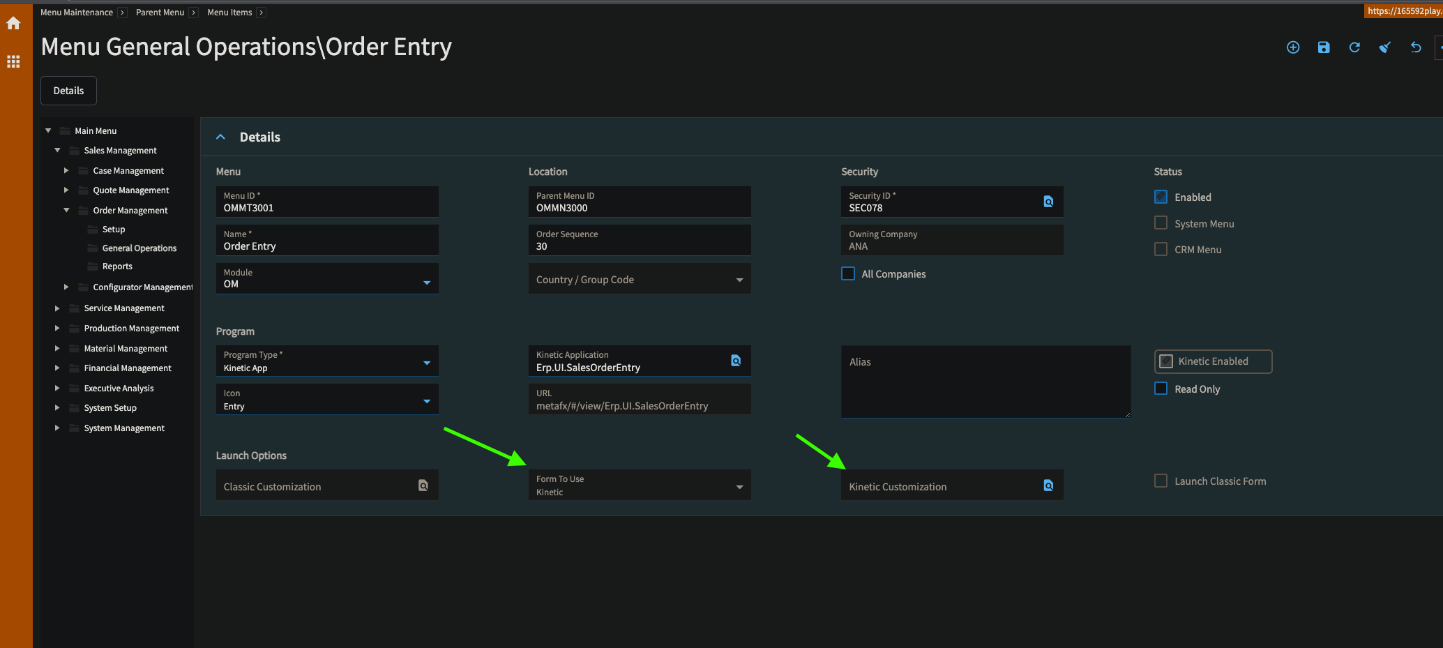

Take a look in Menu Maintenance for the Customer form.
There should be options for how it launches the form (Kinetic or Classic) and if there is a Custom layer associated with that Menu item.
This should get you going in the right direction for it
