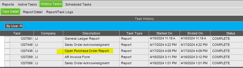

Yes I see all the history. She isn’t intentionally running the report.
She may have accidentally ticked Recurring some time in the past, but there is no schedule for this time.
I’ll look in database just in case something is hidden somehow…
