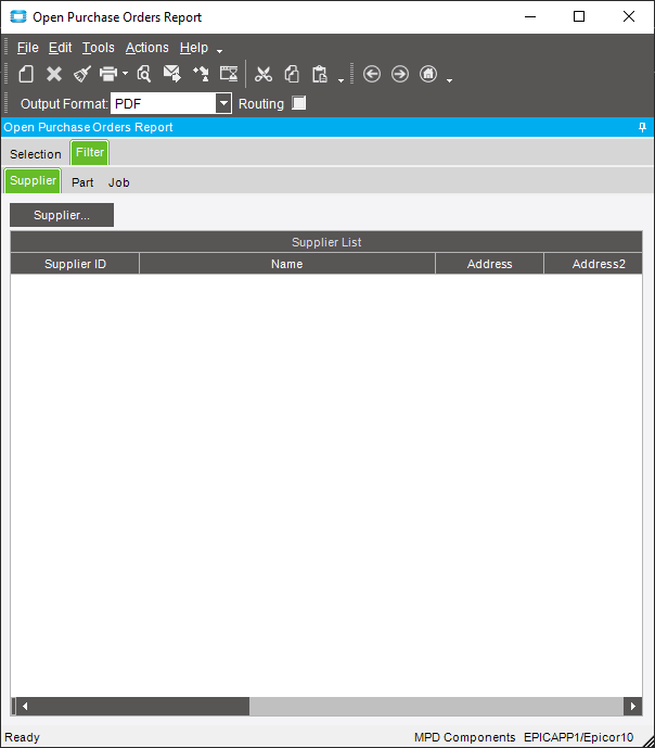

Open Purchase Orders Report Form - Can I add at tab in filter and set up to filter by PartClass?
Hello,
I got hit with a wishlist item that I have never tackled before.
In the Open Purchase Orders Report:
They want to know if I could add a tab in filter to filter by PartClass.
Is this something that can be done relatively easily? Any place with steps on how to go about it?
All help is appreciated.
Thanks,
Shawn
Shawn,
Unless they need the actual report for some reason. I would just build a dashboard for them. Our Purchasing department had a similar request. Building a dashboard they are able to filter anyway they want through all the PO’s.
Regards,
Austin
You can create a Quick Search on Part to search by Part Class and it will be available throughout the system on Part Number. This is what we have done and it works great.
