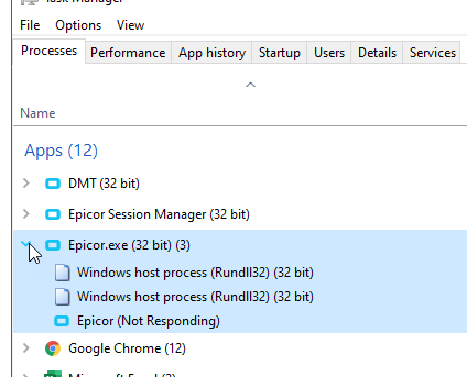

Just wondering if anyone has come across an issue where you try to open up system monitor from the tray icon nothing happens and if you hover your mouse over the E10 desktop you just get the cursor spinning.
When I look at task manager Is shows.
I’ve never seen this before. I tested on the server and the first time System Monitor opened, but now I get the same issue on the server as I do on my PC.
Any suggestions appreciated.
