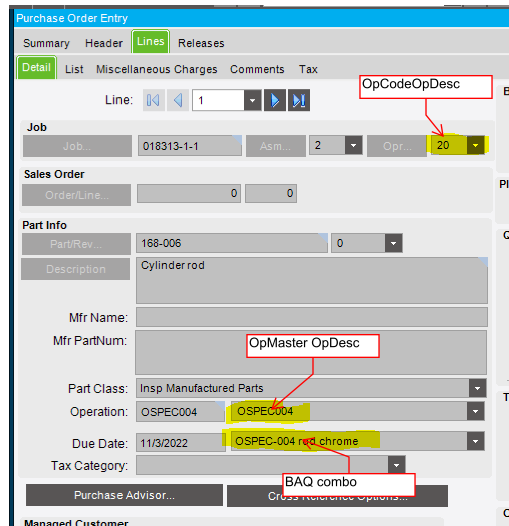

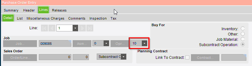

Hey so what is a good way to get the Operation Description to show on PO Entry / Tracker for Subcontract lines?

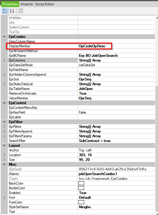

I see the OpCode field is available by default, but the OpDesc field is not. I can’t mimic the combo control from eg JobTracker (OpCodeOpDesc isn’t available in the form).

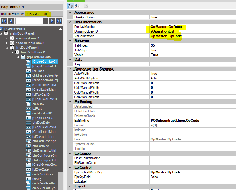

So should I use a BAQCombo? Or Make a BPM to load it into BPMCallContext? Or add UD field to POSubContractLine (or equivalent), and populate it with a BPM?

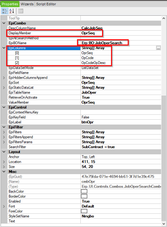

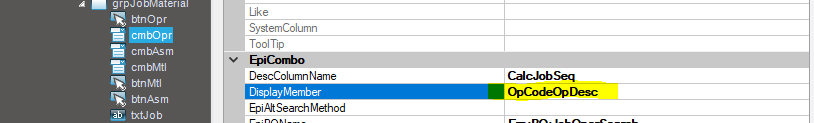

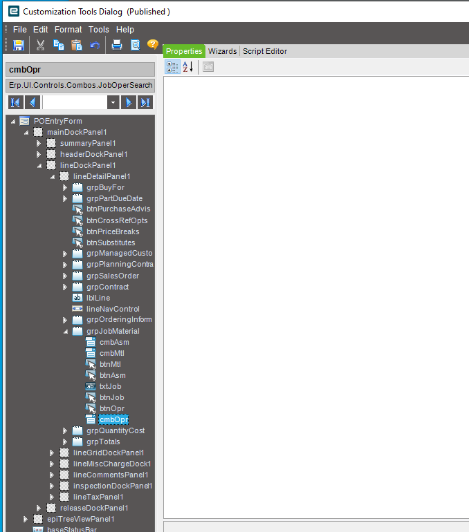

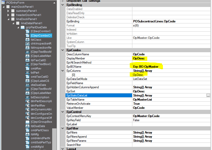

Note that the search in the field is dynamic and it is linked to the selection you make in the Buy For section. When you copy the field, make sure you copy the one with the operations.
Update - Somehow my client install got hosed. Even the base form cmbOpr properties loaded up as blank. Opened fine on a different client. Clear client cache surprisingly didn’t fix. Had to re-copy the install files to my machine.. Clear client cache and restart Epicor and Explorer fixed.
Yeah, it did something weird the first time and I had to delete the customization and try again. I didn’t touch the original dropdown though, all the changes I did were in the copy. Also, you can just create a new dropdown from scratch and then set the properties yourself. Glad to hear it’s sorted.
