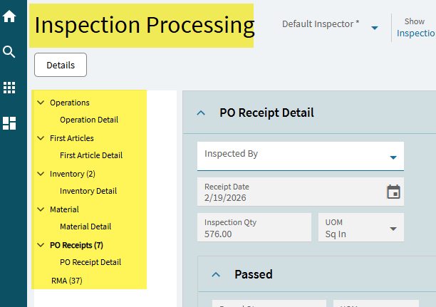

We don’t have the most advanced quality module but the one ahead of that.. IDK what it’s called. Anyway, did you look at inspection processing to see if it is there? It lists the different types of parts that require inspection there.

I just read one of my prior posts in this thread, and you need to set up an Inspection Plan and Specification on the operation in addition to the “Inspection Required” flag. So if you wanted the inspection to be required at the end of the process prior to receiving into stock (or shipping off job in the case of Make Direct), you would assign an Inspection Plan and Specification on the last operation of the method.
Inspection Plans require the advanced quality module.
If you do not have or do not want the advanced module, you may want to consider First Article inspection.
First Article is intended to be used at the START of an operation but it will automatically create nonconformance records and prevent production from happening until the parts are inspected.
