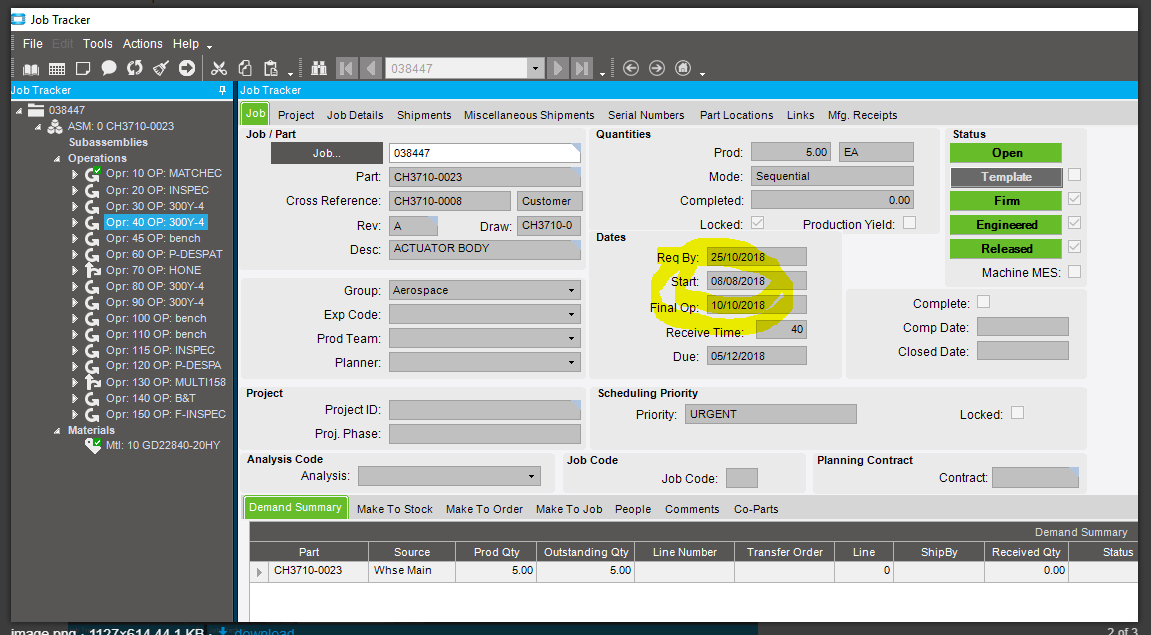

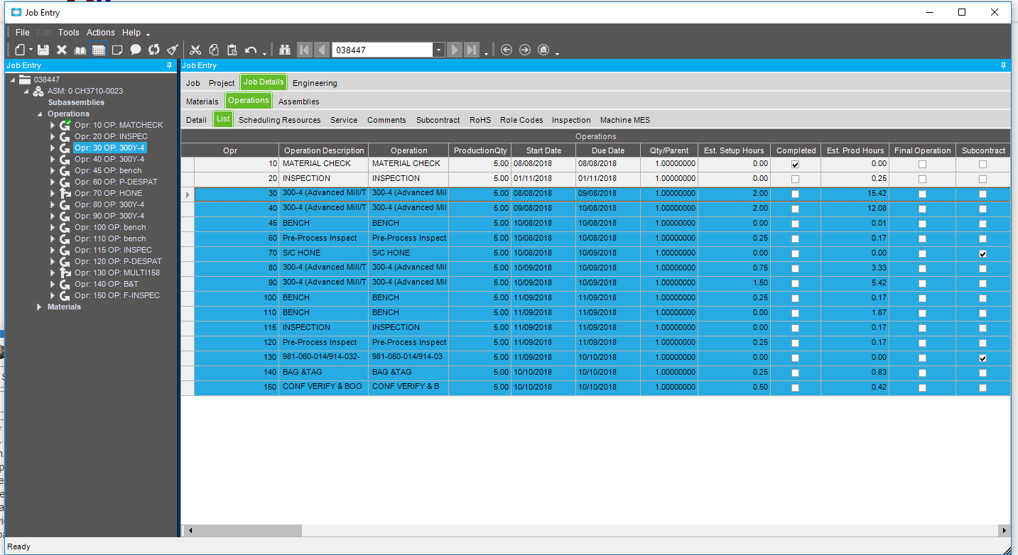

Hi every one,
the nearest topic i found related to my issue is this:
Job won’t schedule some operations
however,
i have checked every stated factor with no luck,
  1. Job operations have got est. time (Setup or Production).
  2. no labor transactions linked to these operations.
    3.still open.
  3. no completed qty.
  4. only one resource group attached to it.
  5. resource group has active calendar.
  6. priority and scheduling factor is right.
    8.run individual infinite forward scheduling task.
  7. run global infinite scheduling process.
  8. Allow scheduling before today is [Unticked]
operation scheduled start and due date are wrong, what i am missing here? has any one come across this issue guys?

I don’t know if this matters or not and maybe you have the format set correct on the back end. I noticed on your Job Tracker that the dates are formatted differently. Are they set that way or did someone make a mistake?
i tried both, but for this particular job i have (forward) rescheduled many times after checking all the listed factors, and still have non-completed operation scheduled to start on the past.
thanks Kim,
no it is set using this format in purpose, i know that when you call dates field in SQL, it will appear differently, but as a UK company this is the date format that we want to see on all UI

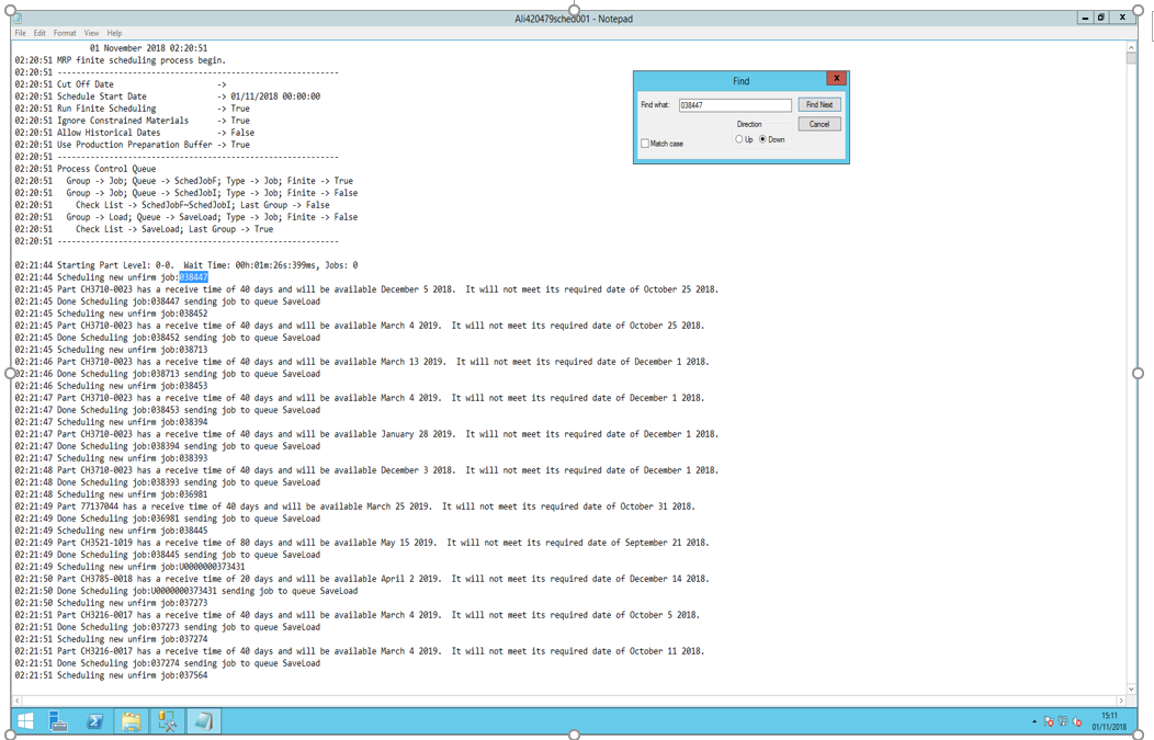

Was there a log generated?
no, i will run it again with log and whatever filter i can apply to narrow it down and let everyone knows
i could not find any details about operation scheduling on the log ( i have selected process and scheduling option to show every thing)…please correct me if i am missing anything
