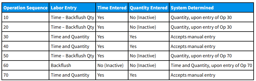

How would a Fixed Time and then using a Labor Collection Method of Time - Backflush Qty work together? As I recall, you can’t report a quantity on these. It determines how many you made based on the time you reported. If your time is Fixed, how would you be able to calculate any quantity?
I think you have selected to use two things that should be mutually exclusive of each other.
Edit: Wouldn’t you really want it to be Q for Quantity Only? You report your quantity and then the entirety of the Fixed time is backflushed?
Second Edit: I was off a bit. For the Time - Backflushed Quantity to work, you need at least one operation afterwards that reports a quantity.

In the example table you have attached, what we have observed is that when we have an operation (in this example Op. 20) that is Time - Backflush Qty as the labor entry, as well as has a Fixed Time value, the operation will not be marked as complete even if a quantity is reported in Op.30. However, it will be marked as completed if the Fixed time is removed, and the operation has a production standard, and setup time associated with it.
