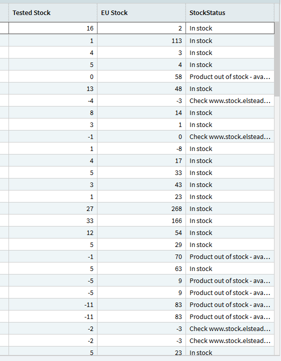

Hello, We currently have Order Ack email out, just wondering how easy it would be to build a BAQ that I can add to the report where it says Line 2 out of stock due to “”“” this would check my BAQ which simply has the Order the Line the SKU and an out of stock reason like this
So on the Order Ack it would say thank you for your order please see ack attached please note the below stock status for your lines
Line 2 - In Stock
Line 1 - Out of Stock - Available 2-3 weeks
Line 3 - Out of stock - checking the website for the new incoming arrival

I have tried doing this through a BPM and I got to a point however it triggered based on the order being saved but instead of returning the record relating to the order it kept returning line 1 on the BAQ
You will need to filter the BAQ to get the sales order it’s processing. Otherwise if you’re just returning the whole baq dataset you’ll only ever get the top record.
Which way round would I do this i tried parameter on the BAQ but it will need data to pass to the parameter but I couldnt get around it
I would pass the part numbers from the Order into an Epicor Function, and have the function call the query and return the message to add to the email.
Create an epicor function that takes a String-type parameter called PartsList, and returns a string parameter “InvStatus” or something like that.
