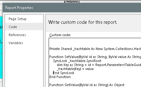

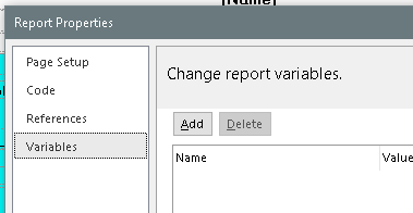

There are other places that the variable needs to be declared, and or updated.
Check the following places on the other report (the one that successfully used those variables):
  • Report Properties -> Variables
  • Report Properties -> Code - for any functions that reference your variables.
  • Any fields that mave have code in them that affect that variable.
I have those corrected, still giving me the same issue. To side step this, is there another ay to do what we are wanting without having to go through this expression? IS there a way to tell if it is a multi-Shipvia order, or a multi-date order?

@ckrusen Well, figured it out! I corrected the variables in the code section of the group and also had it put in the query and list. HOWEVER, I only put ShipTo instead of OrderRel_ShipTo. That fixed the issue…
