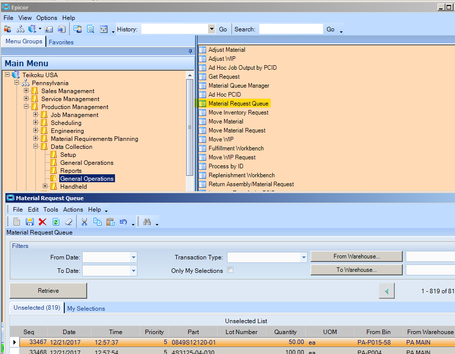

Any chance the Material Request Queue is causing hiccup?
We do not use this program on purpose, but get rows of material requests from the system request move checkboxes clicked on default of various entry programs. Clearing the queue out via selecting the rows and clicking delete (need to do for multiple plants) has helped us with messages of this nature before, normally for us due to RMA disposition or trying to manually close sales order line. You could test it just on your part numbers that are causing problems, if you have a ton of records in the queue like we get.
The user (you) needs to be setup as a material handler in employee setup to be allowed to delete the material queue records.
Nancy
Yes, we have has those problems in the past, and I do clear them out occasionally for the same reasons you stated. I wish I could figure out how to simply turn then off.
This specific case, had no material move request however.
For the ones that are stuck and you want to get rid of, have you tried to unpick them using Unpick Sales Order?
We had had issues where we wanted to decrease the qty on the SO, and I was able to open the line up for changes after unlinking the PO, checking the Mat’l Que, and then ultimately Unpicking the SO.
You might be able to unpick to a WH-Bin and then Adjust Qty to zero?
