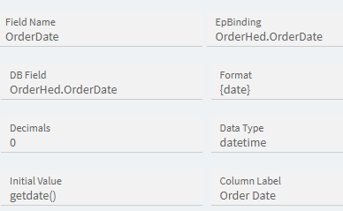

The OrderHed.OrderDate field IS technically setup as a datetime data type:
But unfortunately, it only records the date, and sets the time to 12:00AM.

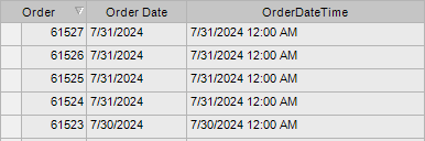

Option 1: Add a UD field to the table and create a BPM thats writes DateTime.Now

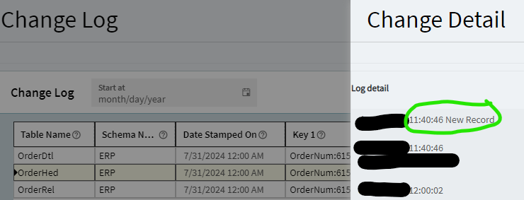

Option 2: Add a change log to OrderHed
Nice idea! The Change Log records the time of a new OrderHed record.

Option 1 Working perfectly :grinning:

Option 2 here…OrderHed, OrderDtl and OrderRel…comes in handy.
