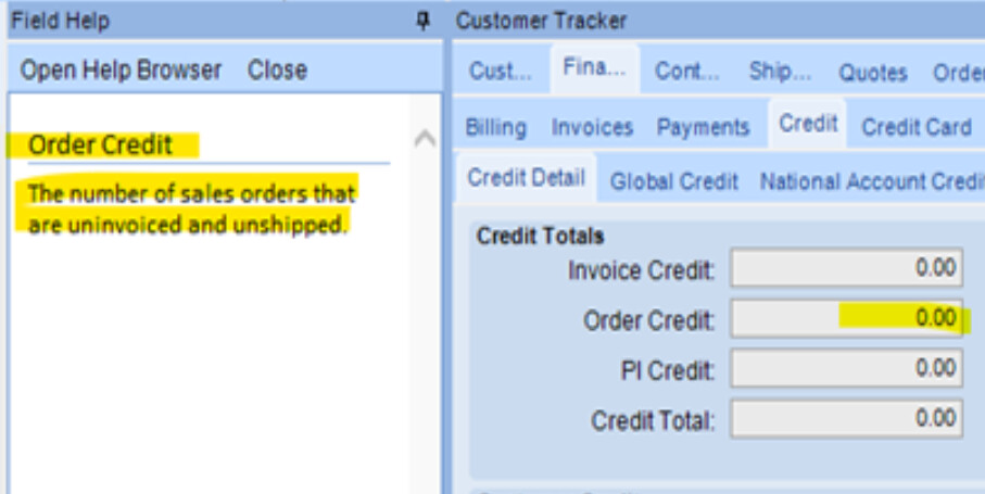

Finance is reading the Field Help for the Order Credit field(Customer Tracker - Finance - Credit - Credit Detail) and it seems to be misleading (“The number of sales orders that are uninvoiced and unshipped”). This field is $0 for a customer that has several open orders. Tech support tells me if we don’t have the “Include Open Orders in Credit” set, open order will not be included(we don’t have it set for the customer). I’m not sure what problem finance is trying to solve, but hoping someone can help us to understand what the Order Credit Field tells us so I can communicate this back to finance(the field help seems to be wrong…). Any pointers?
As support pointed out, that value is only calculated if the “Include Open Orders in Credit” field is set. The bad thing is that if you select that option, then the value calculated for that field is added to the Credit Total.
