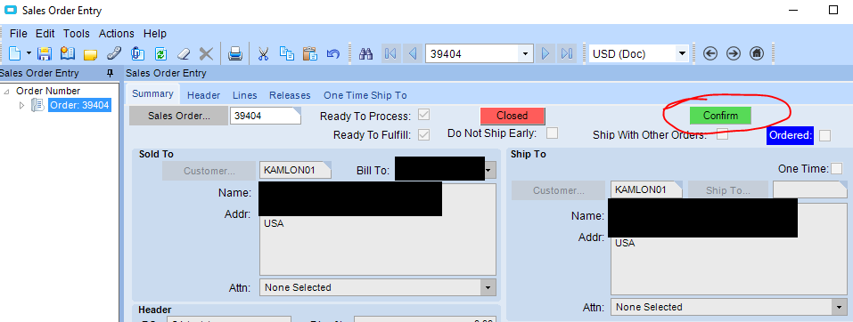

I’d like to write a query based on sales orders that have this “Confirm” box displayed. I’ve noticed that sales orders that have been shipped but not printed also have this “Confirm” box showing. Does anyone know if there’s a database field behind this box that I can write a query against?
Thanks, Sharla
I think this field is associated to “ReprintSOAck” on OrderHed.
Thanks @Fernando. I was thinking it was the opposite. I thought the green “Confirm” button meant the user already printed/viewed the SOA. I see now with some further testing that’s not the case. Thanks for your help on this one!
