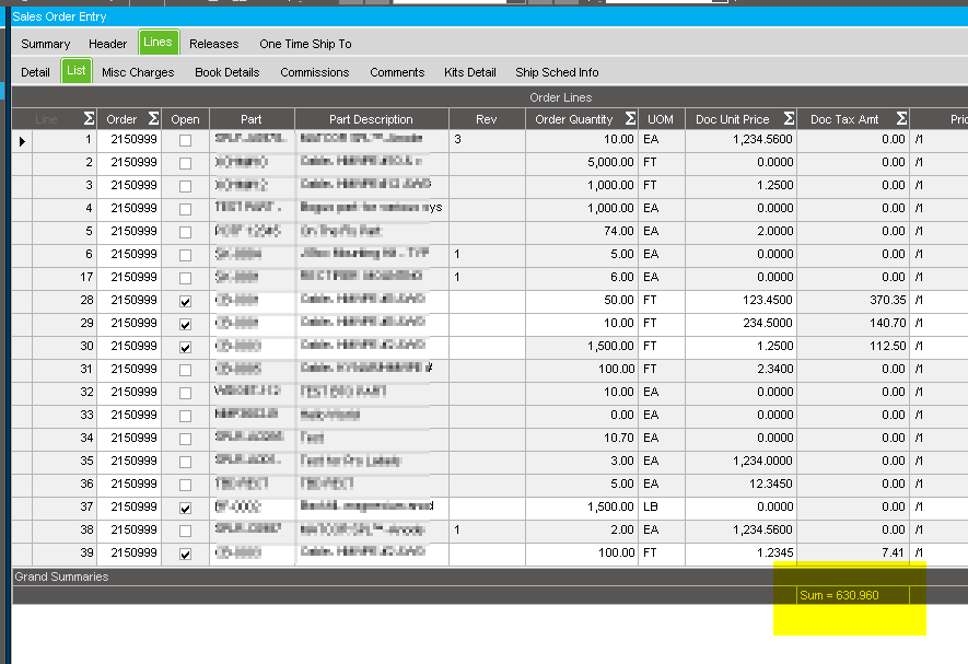

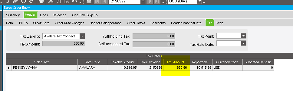

The header won’t have any product group. That’s only on lines. There shouldn’t be any “header tax” unless there a Misc Header Charge.
Or do you mean the tax shown on the summary page?
That should be a total of taxes from the Order Lines.
Here’s a sample Header\Tax sheet
That $630.96 comes from the Order Lines:
