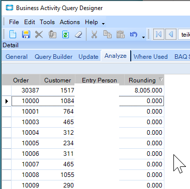

Can anyone here query your orderhed table where the rounding column is less than 0.00 and see if it’s happening? :slight_smile:
Hi Jeff,
We do not have any OrderHed records with rounding < 0. However, we do have one with it > 0 and the funny thing is, it is the one I show in screenshot with the weird cc amount at -8005.

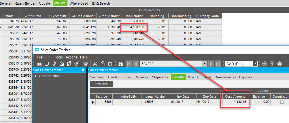

We have some too all seem to be when going from USD to CAD. Also, we too do not use Epicor’s Credit Card processing extension. I checked a few orders where the CCDoc Amount <> Doc Amount and the invoicing always goes off the Doc Amount (OrderHed.DocOrderAmt) column.

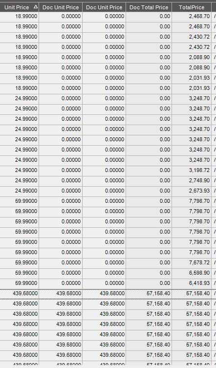

It appears orders can have a negative round value and still be correct, while some others are not. Here is an example. For some reason the TotalPrice column is not matching with the rest of the line because the unit price is not matching doc:
This total price column is part of the epidataview only (not DB)
The summation of all of those total prices goes into the rounding column as a negative:
Doc totals and doc rounding remain correct so the order total is correct. I’m seeing instances where this negative value is staying on the order hed and the non doc rounding amount is subtracting from the doc order amount
