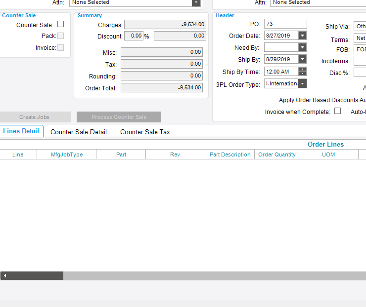

Order Entry negative total with no detail lines!
Hello! This is a weird one… a user was going to create a sales order and just saved the header. No detail lines have been added or charges.
How can there be a negative total!?!!!

Thanks! I’ll take a look. The weird thing is if I copy the order the totals become correct. This issue almost caused us to fulfill and invoice the order being 7k off. That’s a huge issue and support is telling me it can’t go to development unless I can reproduce this issue. This happens extremely sporadically, but it shouldn’t happen it all. I may need to write a bpm to due a calculation and if it doesn’t match the total don’t allow the order to be processed, ya know fixing base functionality

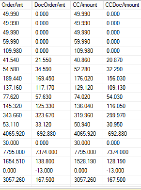

We have 271 orders with this issue dating back to 2015 where the currency code is USD. We also use EUR
This is starting to worry me. Don’t invoices go off of the CCdoc amount? We have 271 orders that are under or over by smallish to MASSIVE amounts

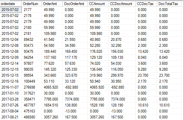

Here is an example:
one with taxes:

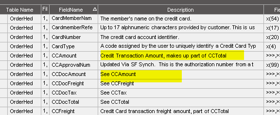

I was just going by the Data Dictionary.
And we don’t process CC’s in Epicor either. Yet we see lots orders with a value in the CC fields.

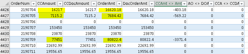

We have no Orders where CCAmount <> CCDocAmount, nor any where Amount <> DocAmount

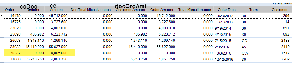

We have a few weird ones in there, per below, many quite old too. Our one with the -8005 on the ccAmt does not show anything but $0 on the sales order entry summary tab. Perhaps yours is probably due to the $ in the ccDocAmt. How you are getting it on a completely new order is very strange though. My customers varied with the weird ones, however I did notice a whole lot of user fooling with pricing/quantities/discounts and sometimes even credit memos and void line thrown in there, when the anomalies occur. Maybe now you know where bad data comes from you can call Epicor support and ask them to send a fix for your data and then you monitor for when it happens again to trace their bug and submit it?
