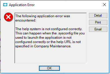

For five years, this has been the only thing we have been able to see when we press F1.
@DWright
5 Years wow!

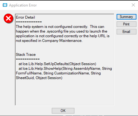

As the error mentions have the three errors in the message been investigated?
Yes. I know. Yes. They have.
I’ve been told that it has something to do with needing to update our servers and all.
I don’t know and I’ve given up asking.

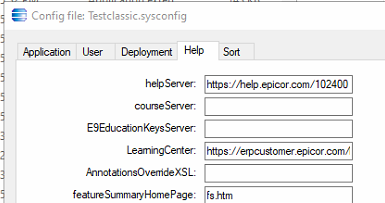

Pop this url into the Epicor help url field in company maintenance: https://help.epicor.com/102300
See if that works. Epicor moved to Azure hosted help so you do not need to install help on your app server anymore.
You can also set for your install in syconfig.
