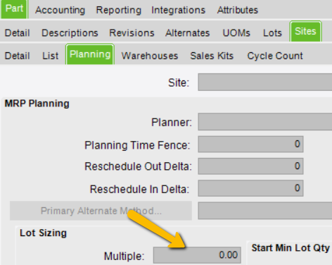

Is there a field that states order multiples e.g. if order multiple is 5 then you can only order in 5,10,15,20,25,30…
Found it
PartPlant.MfgLotMultiple
Applies to both Manufactured and Purchased Parts
Make sure your difference between lot min and lot max is divisible by the multiple, or unexpected results can occur.
