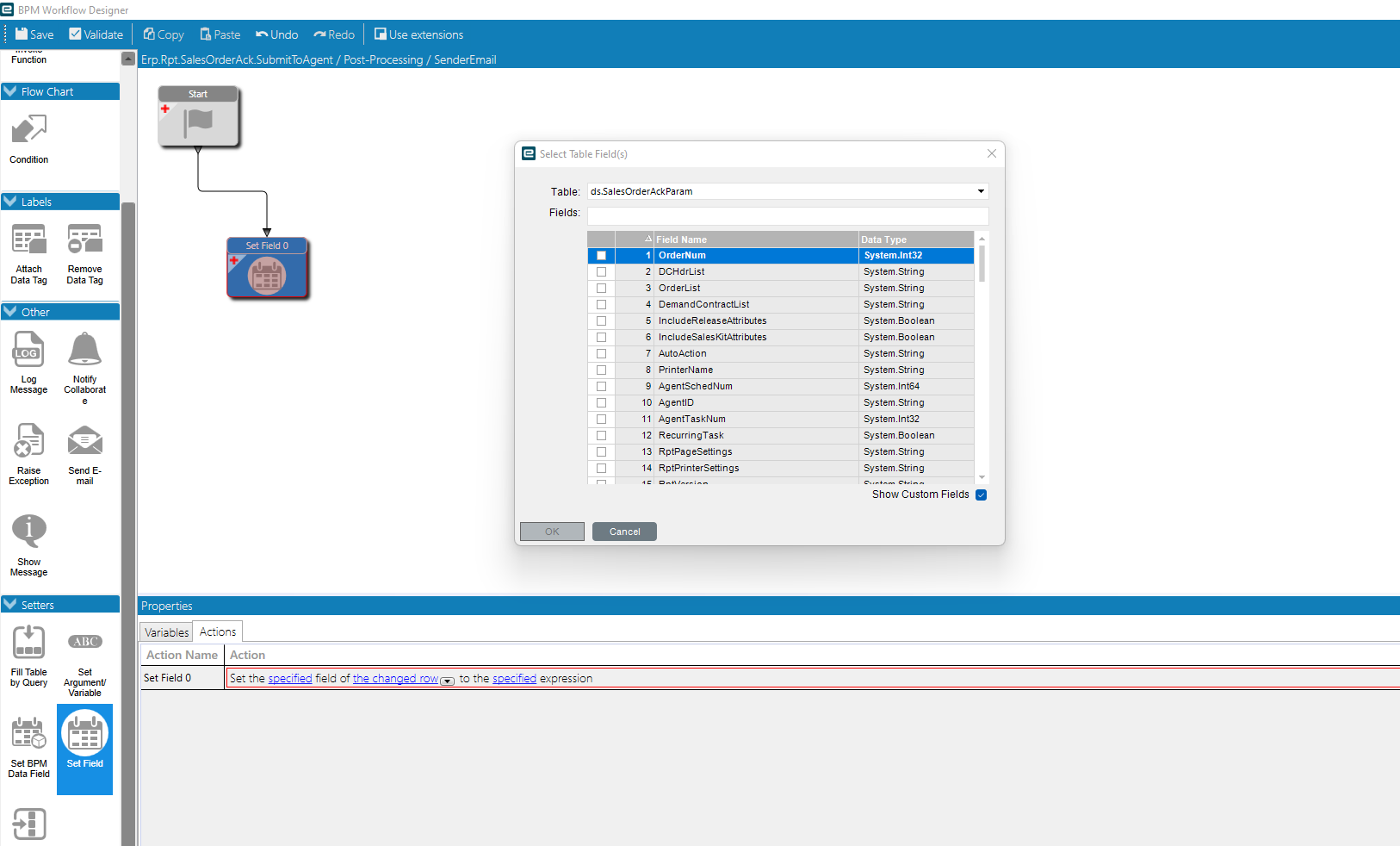

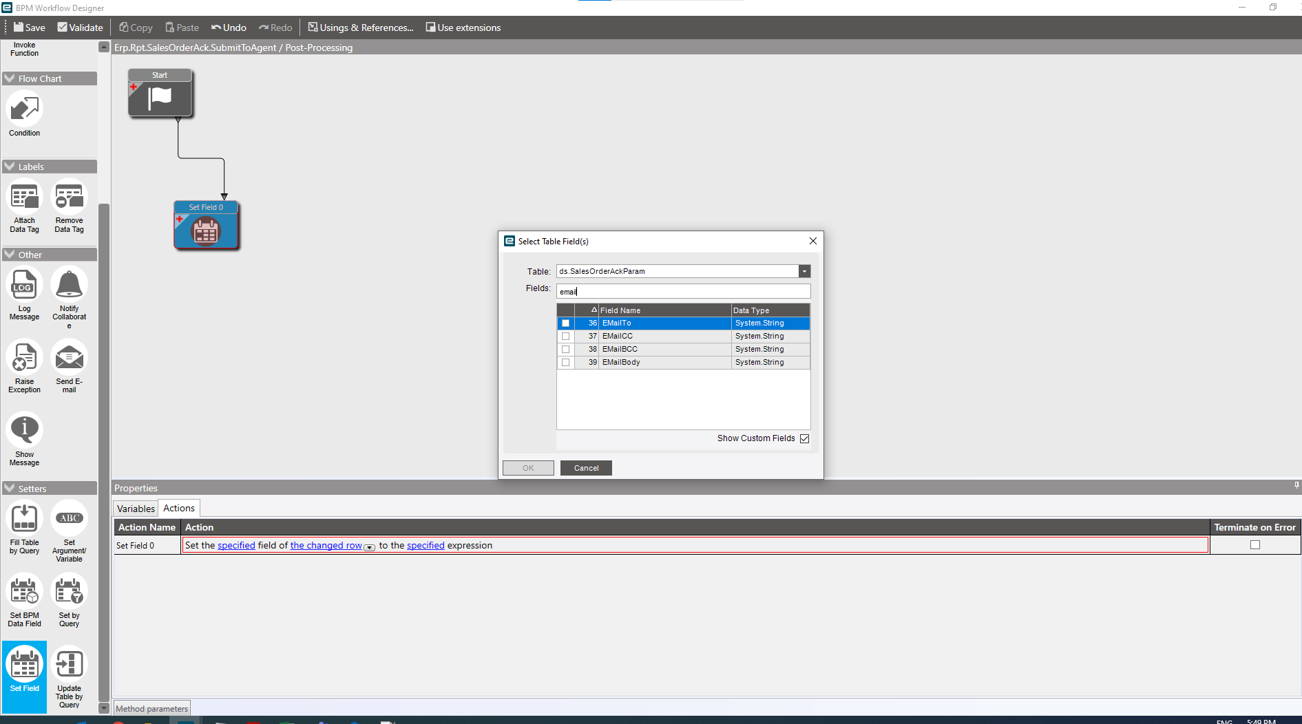

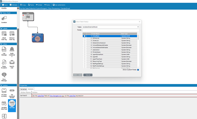

you can do a Method directive Post processing BPM as below and Set Field your email address

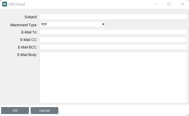

When I click the email button, this is the dialog box that pops up. I do not see a blank for me to enter the sender email address, only the recipient. Am I looking at the same thing you are talking about?
