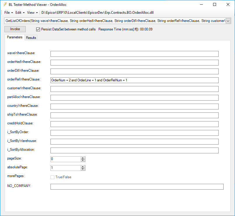

I’m trying to get the OrderAllocList dataset for only one row. I’m using the GetListOfOrders method in the OrderAlloc adapter to achieve this, but the filter in the whereclause doesn’t seem to be working. When displaying the row count it’s showing the count of all the OrderAllocs that are available, even though i expect it to be only 1.

I tried adding the InvokeSearch method before executing the GetListOfOrders. Unfortunately this didn’t solve the issue either. After printing the count of rows of oaDs.OrderAllocList it still shows all rows and the count of the oaAdapter.OrderAllocList.OrderAllocList is 0.
I also tried executing the method with the same Whereclause in the BLTester. In here it does work and it shows 1 row in the Results tab.
