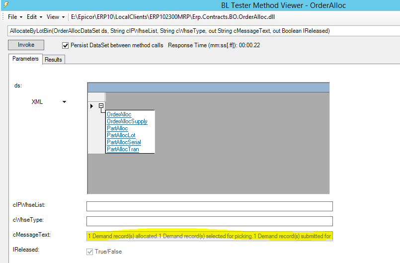

OK, got it. I was able to get the error that you were getting. In the call to OrderAlloc.AllocateByLotBin, these were the minimum things that I needed to set in the dataset:
PartAllocLot[x] table (where x is the row that you want to allocate from)
Allocate - set to true
NewAllocatedQty = int
PartAllocTran table
ReleaseToPicking= true
Adhoc = true
RowMod = U
I think the thing that solves the error is making the PartAllocTran row dirty by changing a field. In my business case we want to release to Picking, and we don’t use allocation templates so changing these 2 fields to true makes the row U state and all is happy.

I was able to get it to work in BLTester without using these 2 calls:
CheckDates
OneDemandType
As listed in my previous post, I only have to set a few fields
Allocate(true), NewAllocatedQty(qty), ReleaseToPicking(true),Adhoc(true)

I was able to skip GetLotOnHandByWhseCodeZoneBinType and create my own PartAllocLot row from a baq. The key is to make sure to specify the warehouse on the AllocateByLotBin call. That makes the PartBin record update.
Also, the PartAllocTran column for Adhoc is “AddHoc” in the datatable… this threw me a few times
