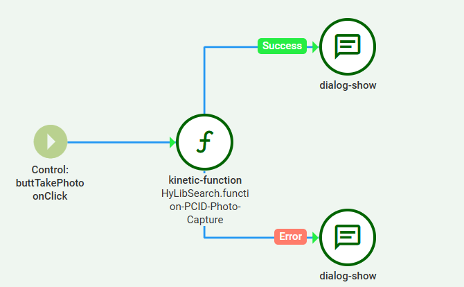

Yes the API works on Postman, when we trigger the function through a button in app studio it never hits the server even when we use an unauthenticated api end point.
Here is the flow of the button click:
the dialog show widgets only show alerts for success or failure
Do you have a base process of how you set your function up for this functionality? This is the first time we are trying to do this so there may be something within the set up that I am missing.
