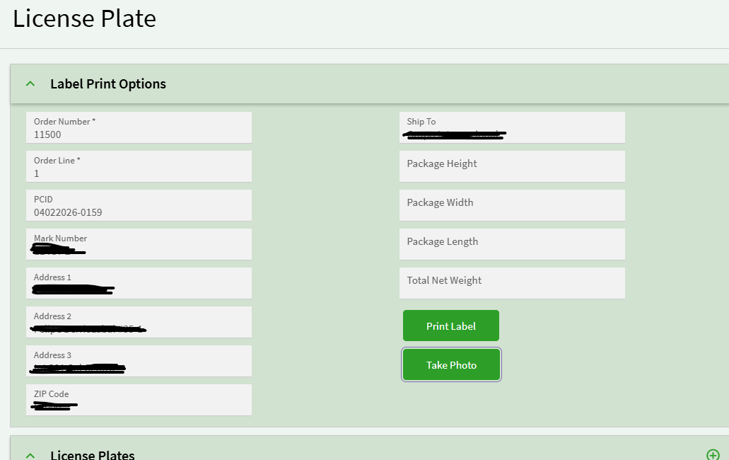

The ask is to create automation for when a License plate label is printed (on a custom screen) for a specific PCID (container number), an image is captured as .jpeg, via API, from the assigned crating area and have that image attached to all Sales Orders that are assigned that PCID # at the OrderHed level.
Here is the first version of what I was trying to do: Step 2 was moved to the top to see if the steps before it were breaking the function but it was originally after step 1 (naturally).
Step 0 will be modified later since the all the cameras have yet to be set up and API’s built for them.

I have the method parameters set up correctly I think, but somehow its not attaching to the orders,
Where is this being triggered from?
It is being triggered on a custom slide out for Label printing on the MES page:
