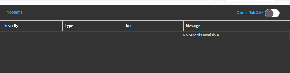

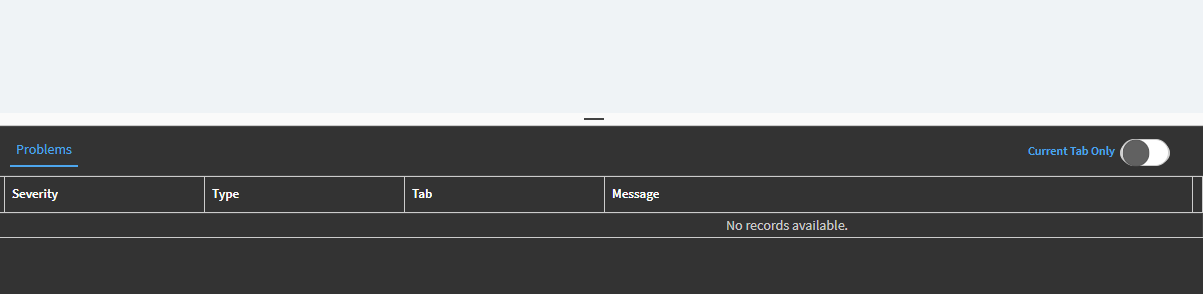

In 2024.2, we are getting warnings of orphan components in our Job Entry and Job Tracker Menus. This of course didn’t happen in 2024.1. I go to application studio to find these orphan components, but nothing shows up under the problems, and I cannot find the orphan components at all when I manually search through all the sections.
The worst part about this is that when I preview in application studio, there is no warning of orphan components. Has this ever happened to anyone before? Why would this only happen in this newest version? Is there a way to just have the application ignore the orphan component warning so this doesn’t constantly show up for my users?

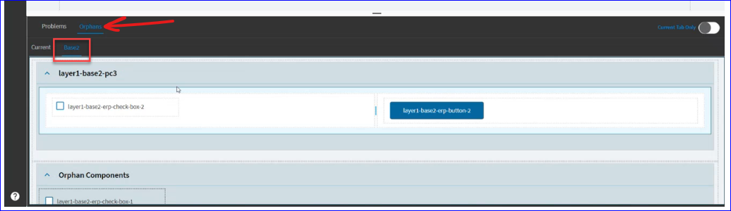

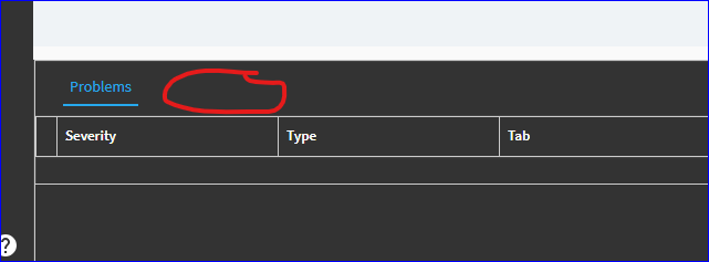

This time… I think they added a new area in the “problems” area at the bottom. I think it may have been here:
Just looked, there is nothing there for me.
Crap… i know I had to look around for it too, and can’t remember where it was. I’m looking through random pages now seeing if I can find another one :rofl:

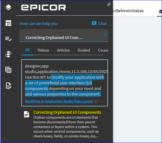

Just looked at “Help” and that’s where they’re showing they should appear:
You can look up that Help Article:
I looked up that help article, and it was not very helpful to me. The article shows the section showing where orphan components are, but that part does not show up for me.
I do have 2 custom layers in job entry, but neither one of them shows any orphan components. I made sure to check the base layer too, and that had no orphan components either.
