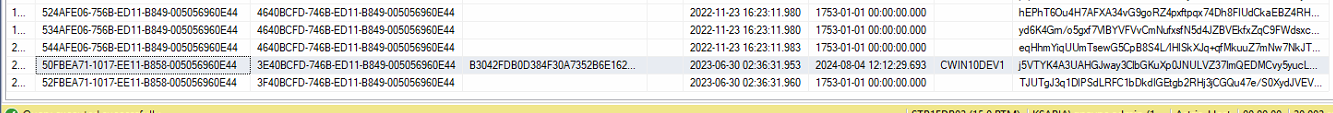

@Banderson In the Astria_Host Db is a table LicenseSeat when a request is done the MachineName and MachineId are written there. When a release is done the MachineId and MachineName are cleared. I tested clearing without the client and being able to request on another machine and it was able to request without issue.

You need access to the DB though, I unfortunately don’t have that cause # Cloud… #ItsGreatTheySay
