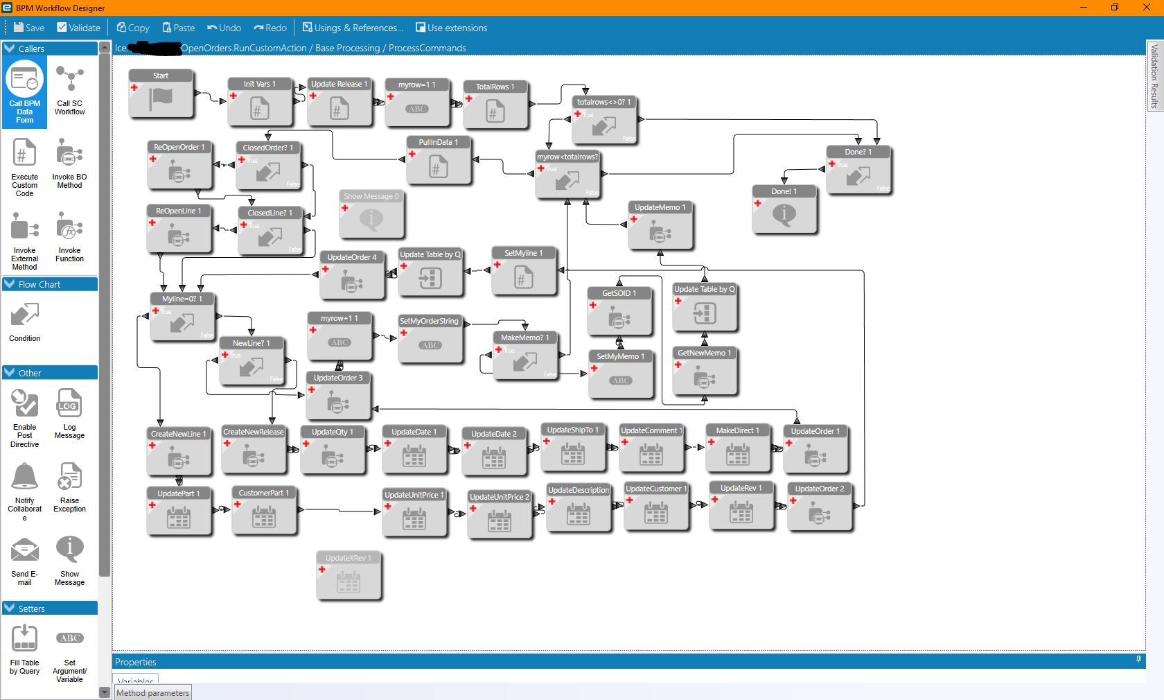

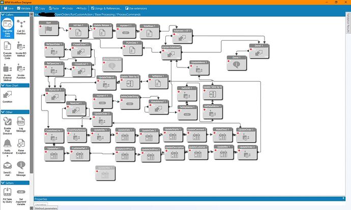

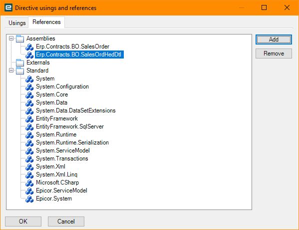

Good morning,
Does anyone know an easy way to trace down what is failing in my UBAQ directives after this recent update? Some of my BPMs are kinda big and complicated:
All the syntax passes. How do I find what element is failing and preventing this from being updated? When I try to save the BPM for this UBAQ, I get some errors pointing to OrderDtlRow in Erp.Contracts.BO.SalesOrderHedDtl, and Erp.Contracts.BO.SalesOrder.
I went through each widget and I don’t see any specific references to OrderDtlRow in my custom code, or in any other widget. I did access and use the SalesOrder BO methods extensively here, so I expect this is from some internal method that got broke during the upgrade.
How do you track down your offending elements?
Thanks for your time!
Nate

EDIT: I see that in my BPM “usings and references” I have the two assemblies that are referenced in the error. I removed the highlighted one, and the compatibility error went away. It seems like this did the trick!
