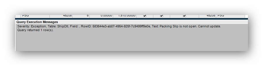

Occasionally we will have a customer contact us and ask for a packing slip to be modified after the parts ship and are invoiced. Does anyone know of a workaround or cheat to update shipdtl records so we can print a corrected packing slip? I tried an updateable baq but are getting errors. I suspect the BO logic prohibits updating.

I think if you add UD fields to ShipDtl and the record is locked down due to being invoiced, the UD fields are still locked through the business object. At least, that’s my experience with UD fields added to LaborDtl and POHead. The records have to be unlocked by either Recalling or Un-Approving the records before you can edit the UD fields.
Alternatively, you could tie a UD table as a child to the ShipDtl – that would allow you to continue to make changes to the custom fields after the invoice is posted.
I thought there might be a chance that the UD fields would get locked. But was hoping that they wouldn’t, as not all do. The TrackinNumber field is an example of one that is changeable after being invoiced.
