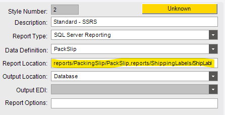

PackSlip is a strange one because you actually pass in two reports on the Style line (note the comma below). The UI also has the option to print one, the other, or both.

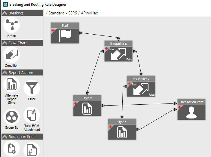

However, within APR you have the ability to pick a style based on a condition:
With a lot of conditions, it could get ugly. But if you have a manageable number of selections, it isn’t too bad.
Sorry, I didn’t include this but APR can also choose different printers.

Unfortunately I have setup the labels with bartender and I don’t believe APR works with Bartender report styles only SSRS report styles.
The other question I am going to have to do some digging into is if I only include one report in the report style what will happen. If I have a report Style called “Shipping Labels” that only has the shipping labels report will it only print when I select the pack slip (Which I assume… ugh… is the first report) or shipping labels (assumption is the second report). I’ve got some digging to do, and will post an update on here when I’m done in case anyone else is in a similar boat.

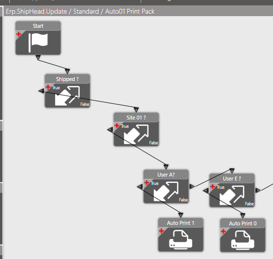

We use a Data Directive, Auto Print triggered off the ShipHead.ReadyToInvoice changes from False to True. Then the pack slip prints for the shipper. But we are on 10.2 ver and this doesn’t address your label question.
