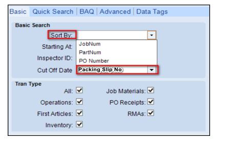

“Packslip No/GRN number” as an additional filtering option to be included in the Inspection Processing under “Sort by option”. In “Inspection processing” screen, sort by option to be added for “Packing Slip/GRN No” too. Currently it has only Part No, PO No and Job No.
By Standard, under Inspection Processing screen, sort by options are available only for Job Number, Part Number and Purchase Order Number.
please go through attached screenshot. kindly guide me step by step way to do this. million thanks in advance.
the marked content (packing slip no) in screenshot needs to be added
Not sure we can change this screen, but a BPM may be able to set the sort to the pack slip if there isn’t a sort provided.
You can do this by using Quick Search. There is very good help in Epicor on how to setup one.

Have you successfully created a Quick Search for this screen? If so, please share some of the ways you got past the roadblocks (like Tran Type and returning the record to the screen).
I have not done on this screen but on many others. If you give me some test use case I will try and see what I come up with.
Vinay Kamboj
Ok. Just confirming. I have made many complicated Quick Searches, but this screen is very different.
